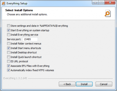

Looks like void solved both our requests, and the latest beta has tons of options to make it silent :)
mooms, if you think on making a silent installer and post it somewhere, please make it with your custom ''Everything.ini'' inside, as I also want to change something easily in it (reason beeing this).
Thanks :)
Yes, I have seen that. Right now, I'm still using my own silent installer based on the inf made by Geej, because it is smaller, but I have tried to make an universal (x64 & x86) installer besed on the originals installer and it works.
If you want to make your own custom installer, here is some batch commands example I have used (you must have the right file in the right folder):
ren "Everything-1.*.x64.Multilingual-Setup.exe" "Ever64.exe"ren "Everything-1.*.x86.Multilingual-Setup.exe" "Ever32.exe"".\bin\7za.exe" a "Everything.7z" "Ever64.exe" "Ever32.exe" "Everything.ini" -mx=9copy /b ".\bin\ev.sfx" + ".\bin\ev.txt" + "Everything.7z" "SFX_Everything_1.3.4.685b.exe"del "Everything.7z"
Example config file for the sfx: (You have to add the argument for using the custom ini)
;!@Install@!UTF-8!GUIMode="2"MiscFlags="4"RunProgram="x86:Ever32.exe /S -install-options \"app-data -disable-run-as-admin -install-run-on-system-startup -install-service -install-service-port 15485 -install-start-menu-shortcuts -language 1036\""RunProgram="x64:Ever64.exe /S -install-options \"app-data -disable-run-as-admin -install-run-on-system-startup -install-service -install-service-port 15485 -install-start-menu-shortcuts -language 1036\"";!@InstallEnd@!
