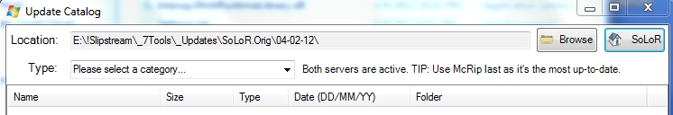

Update Catalog
SUGGEST : i think this is confusing as there are 2 instances of the 'Update Catalog' button ('Main' > 'Basic' and 'Downloads') which apparently do different things; one points to the SoLoR and McRip repositories while the other points to hotfix.chris123nt.com. it is my understanding that hotfix.chris123nt.com is a mirror of only the SoLoR updates. seems like the the functionality of both of these buttons should be combined maybe?
Note: Combined both buttons.
also i found it difficult to figure out how to download all the post SP1 updates - it's kind of confusing when there's 3 sources being used and the description of the SoLoR and McRip updates might leave one with the impression these are only LDR's which, apparently, is untrue. i was also looking to download only the post SP1 GDR patches, but this is not possible as far as i can tell
Note: 2 sources (SoLoR and McRip), it's not possible to separate LDR/GDR Updates. Don't know how it's difficult, just select the updates you want, select the download folder and click go :/

Not sure about the SoLoR button anymore:
Attached File  UC Button.jpg   64.15KB   1 downloads
EDIT: Forgot to give a big thanks for all your awesome work!!!

The downloads - update catalog button doesn't seem to do anything now ...
as in it doesn't download, or isn't displaying the files? this happened to me too, but apparently the cause was that the server(s) were off-line (nothing to do with WTk)
and YES! that link you provided is great! i see SoLoR is involved in that as well. i'd suggest the link be added to WTk UI

The downloads - update catalog button doesn't seem to do anything now and I really think this entire thing needs some additional options and thought seeing that their are other major resources available... as an example (no disrespect to anyone) I have never seen any resource anywhere like Komm's list:
http://windows-updat...sts/Win7x64.htm
Removed SoLoR button and fixed the button within 'Downloads'
