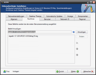

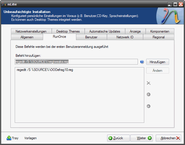

  3. In that case, I strongly suggest you just use nLite to add this, just they way I did. Least chance of doing something wrong and you aren't missing out on something by not doing it manually, either Yes, and silently, due to the /s switch. I'm not sure if that is even possible (not that I know...). What would be the potential gain in this? I'm not sure how this would be affected by stuff such as sysprep, however, as long as you install from a simple disc, I think this method is sufficient. Just search the board for it, there's an O&O Defrag 10 AddOn and I took the reg file info all from that thread (thanks to Rick!). I just didn't want to rebuild the AddOn hence I applied the reg info that way. Also, using the method keeps things tidy when you use a lot of apps that require reg info, plus, you won't have to rebuild each and every pack as it gets updated, too. If you want/need the reg file (minus the "relevant" info, of course ), just raise a hand

    So I searched the net high and low and actually did found some results in the official WA forum but these left me more confused than before... Apparently, the NSIS installer isn't very unattended-friendly, it seems. I'm thinking about doing the whole batch (WA itself, WA Essentials, my default settings and bookmarks and WA TV --> www.tv-plugin.com) in WPI, which is probabaly the least troublesome solution. Hence, it is not essential to have this as an nLite addon, however, it certainly would be nice (I already got MPC from the K-Lite pack as well as WMP11 so that ground is well-covered already but WA got the certain something those two lack). My first try was of medicore success, it was unattended for some settings, but not all, hence breaking my installation :/ If anyone got an idea on how to get this going while maintaining the ability to pre-select all the settings (i.e. do not register any filetypes, install all components) that would be great. The thing I am a bit reluctant to using WPI is because that would most likely require me to use a second DVD because I have so much stuff to fit on that... At leats until someone comes up with Dual-Layer DVD+RWs

  21. I was going to write up a step-by-step guide on how to do this, however, halfway through I figured it would be easier for you to just attach the needed file for you Open this REg file with your favourite editor and replace the programme name as well as tzhe path with your own. Do mind the double back-slashes (\\)! Now copy it to your source. You can either use nLite to add it or call it manually by an entry in your winnt.SIF in the I386 dir of your source. The entry needs to be under [GuiRunOnce], if not present, create it at the end of the file. regedit /S %SOURCE%\TWEAKS\TheRegKeyYouWant.reg I'm not sure if this works 100% because of the %source% reference so you're on the save side using nLite. Just add the same line into the app. That should do it basically. HTH so far test.reg
