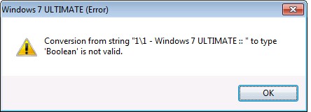

  9. Hi am new here to the board... I really enjoy the software, I just started to use it last week. Although I have been having trouble with the toolkit since, not sure if anyone has been having the same trouble, I looked all over the place to see.. The file attached has the errror message, I used version 2a, 3a and 5a of the toolkit, so I don't think it is on my end, I started with a clean copy of Windows x86 and added the M$ updates from the list of http://www.softwarepatch.com/windows/index.html http://www.softwarepatch.com/windows/windows-7-security-updates-2009.html and http://www.softwarepatch.com/windows/windows-7-security-updates-2010.html I did not use the beta update packs from M$. My suggestions for the next release wouold be able to change the junction points or add a fake juction point to the following... Program Files, Users folder, Temp folder. I did this with Windows XP and because I partitioned the drives the hard drive performance was always 150-300% faster in reading and writing files in NTFS format not to mention Scan disc and defragging the drives were muich faster too, I could set it up to defrag drive D and go to lunch and come back and it would be waiting for me to do something. Thanks for your help.
