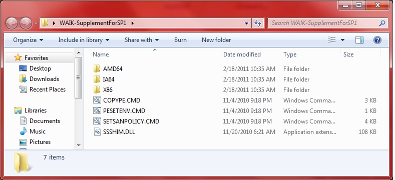

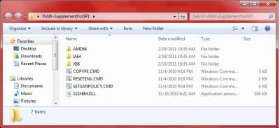

  6. ricktendo64 and Kelsenellenelvian, it appears that MS has substituted links for this "supplement" for all the Windows 7 WAIK links. I DLed the "supplement" and it certainly looks like exacty what ricktendo64 says and the ReadMe has instructions for replacing the current files. Now, I cannot find the Windows 7 WAIK and I need to look at it to see if I can find these files and replace them. Anybody have a link to the original that works? Thanks, John. EDIT: I found my copy, thanks anyway. EDIT AGAIN: Looks like MS has restored the links to W7 WAIK, but now I cannot find waik_supplement_en-us.iso. Really weird how MS thinks.
