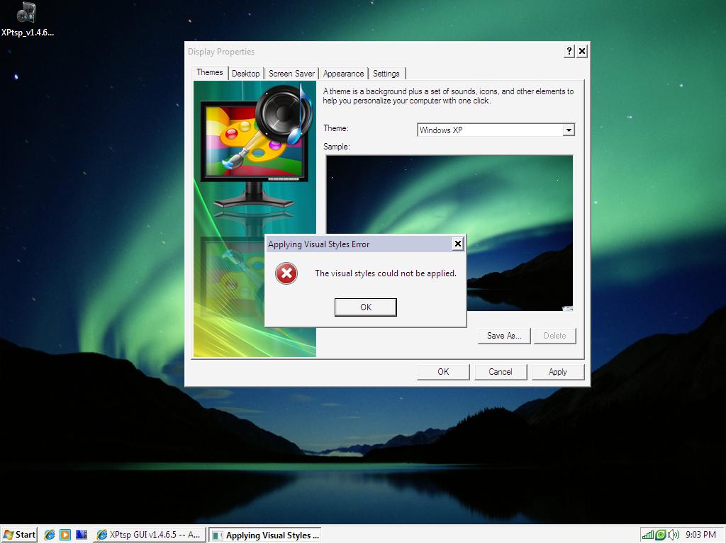

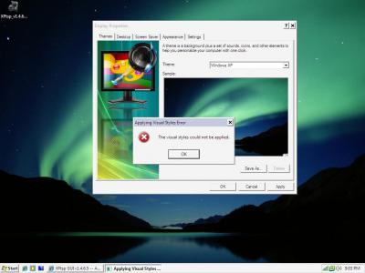

  2. I'm having a problem after installing v1.4.6.5. When trying to change my window theme I get the error "The visual styles could not be applied". The previous version I had installed worked fine (v1.4.6.0). Thanks for all the effort here though, it's really appreciated.
