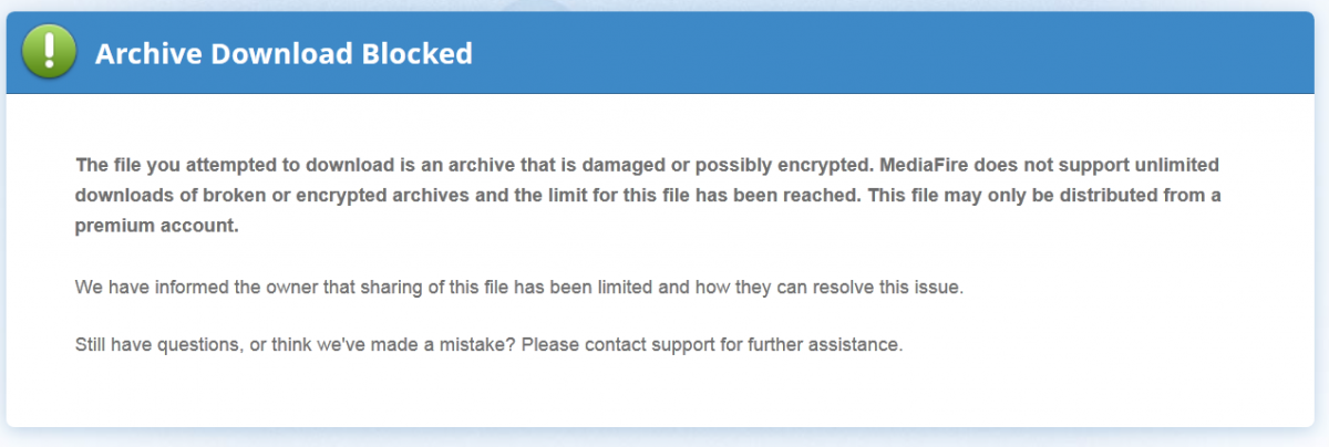

  5. Still blocked for me on IE9, FF19.0, and Chrome 25. It probaly works for you since you're logged into your account. Here's the link that returns in every case: http://www.mediafire.com/error.php?errno=393 Here's what's displayed:
  6. It appears that MediaFire is blocking the download link :rtfm: . Anxiously awaiting your fix.... :doh:
