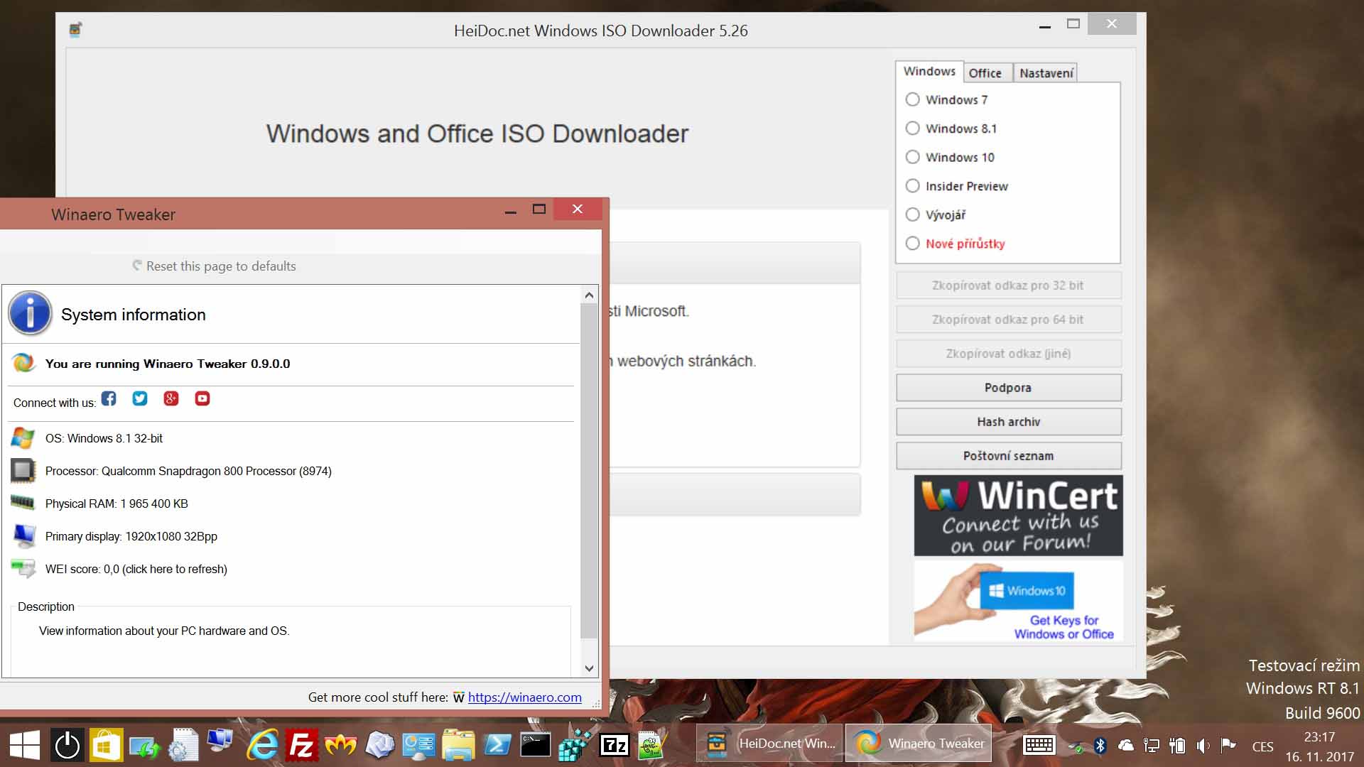

  4. Now (without legacy .NET3-5) it runs on Windows 8.1 arm32 (RT) as well:

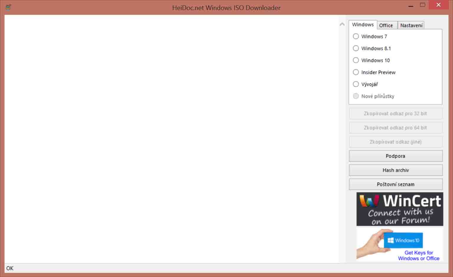

  13. Hello, I got exact same error with modded version. Could you try to temporarily disable the initial pop-up window with traffic donation? It seems to be connected to that. Is there any remote debugger?
