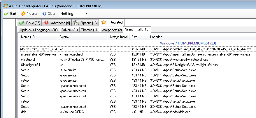

I added several "setup.exe" files in different directories to the silent installer. When I integrate the project they are all thrown into the same directory and inevitably most are overwritten. Furthermore, the files from the source directories (when included) are comingled.
Identically named files should be given separate directories (e.g., \setup, \setup1, \setup2, etc) so they will not clash
post-40013-0-52782500-1348137054_thumb.p

Maybe a different way of doing this would be possible. Legolash2o, could you give the user the option to pick the directory names they go in? (And then give a warning if any of the directory names are the same.)
