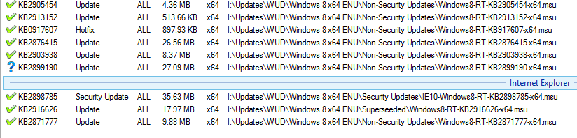

Using 1.4.29.18 i noticed when integrating updates into the iso, When i try do the whole folder for Windows 8 (dl's via WUD) I get errors with a number of updates being pink/red
however I take those updates from the folder and place them separately in another and then integrate them they integrate fine being green.
This seems specific for non security updates oddly.
What could be wrong?

Here you go some ini's and screenshots
http://drive.google.com/folderview?id=0B_QNEP8RAKhsU3VXTVpkNGR2eGM&usp=sharing
I'm using windows 8.0 pro, downloads of patches/hotfixes is via windows update downloader
10-12-2013 list and using WTK 1.4.30.12
error 1& 2 are the same, error 3 is taking all the ? marked patches and placing them in another folder to integrate.
error 4 is all patches except : Windows8-RT-KB2899190-x64, Windows8-RT-KB2877213-x64 & Windows8-RT-KB2876415-x64 as i thought they maybe the problematic ones.

So moving this to the very end allows other updates to go through successfully, still testing atm seeing if any other issues arise
Ok so kb2871777 needs to be the very last thing after IE
rollup kb2876415
rollup kb2903938
camera codec kb2899190 is still causing issues :/ might try place it first.
post-3930-0-89653100-1390710684_thumb.pn
Could you please make KB2871777 always the last to be integrated by default as per ms's know issues.
