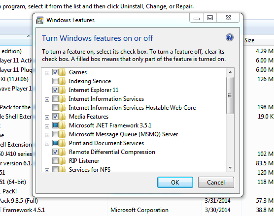

The only thing I can think of is that Win7 comes with ie and since ie8 was never installed (Which you could have done from the add\remove features BEFORE installing ie11) then there may be some missing files and or reg entries.
ie8 could have been installed via this:
Things like this is why nLite\vLite doesn't support corp uses. You made the decision for your client that she may never need ie when, in fact there are ALOT of things ie is needed for the standard user.
Now instead of here having a system that can activate her program you have spent many hours and days trying to fix it and will most likely have to do a reinstall....
Personal note A couple of days for a reinstall? Even without having automated installs or anything a reformatt won't take more that 6-ish hours.... 30-45 minutes for windows maybe 2 hours for apps (Shes 80, she can't need that many) then all of the updates and tweaking for her...
p.s. there are downloadable installers for ie9, ie10 step upgrading would have been a better option too.
