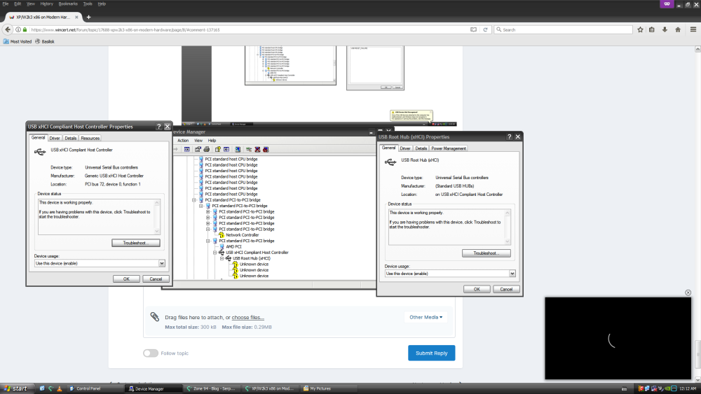

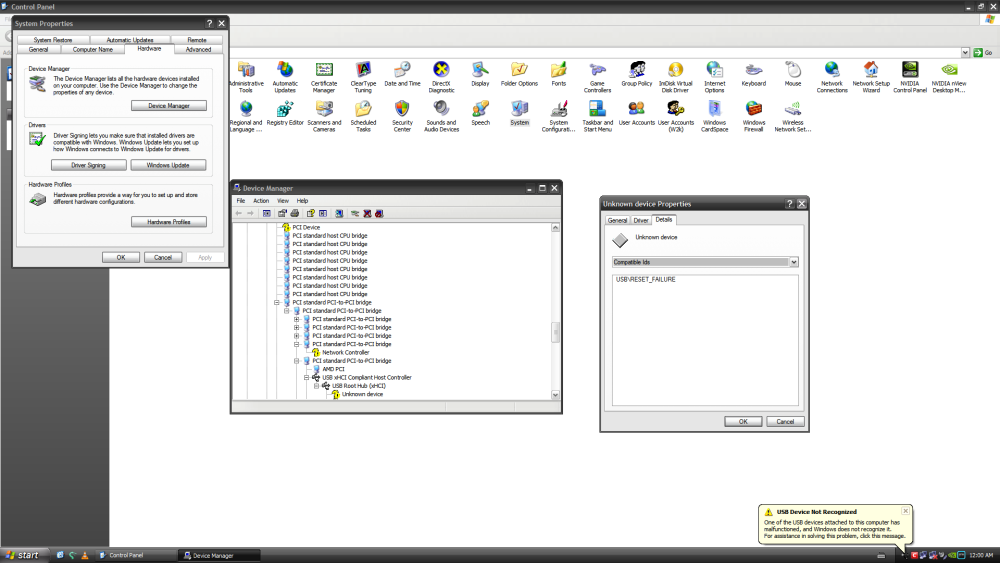

  23. Some further research - 148C controller - works in XP - is device \_SB.PCI0.D0B8.XHC0 in ACPI table if win10 is correct. 149C controller - does not work in XP - is device \_SB.S0D2.D2A0.BYUP.BYD8.XHC1 in ACPI table if win10 is correct. Now I just need to figure out what exactly in the table I need to change. ^device tree too long? I've attached my ACPI tables for anyone curious. TRX40_DESIGNARE_ACPI_TABLES.7z
  24. A disable and re-enable of Root Hub (xHCI) doesn't fix it, only doing that to the controller works.
