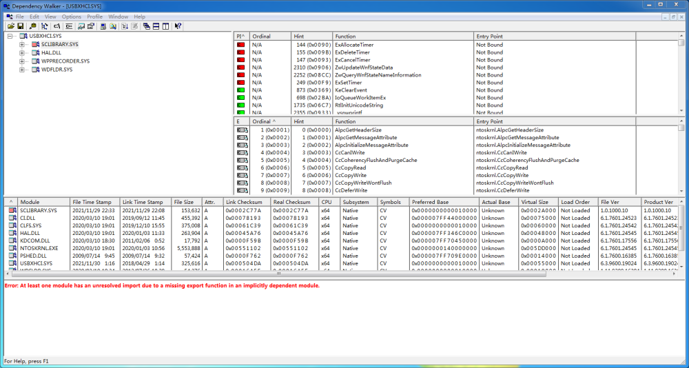

  5. @Mov AX, 0xDEAD@Dietmar I already porting the usb driver from win8.1 and win10 1511, but they will code 10 error on win7. What I need to do with the inf file?

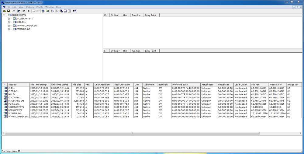

  6. @infuscomus TRX40 have 148C and 149C, 149C is from chips, 148C form CPU, do the 148C have this problem? If We want to porting the XHCI driver frome win8.1/10, we need @Mov AX, 0xDEAD help us to porting win8.1/10 usb driver. I can not solve those Timer funtions.

  8. I think it is too hard to porting the win8.1 usb driver to work on win7/xp system.
