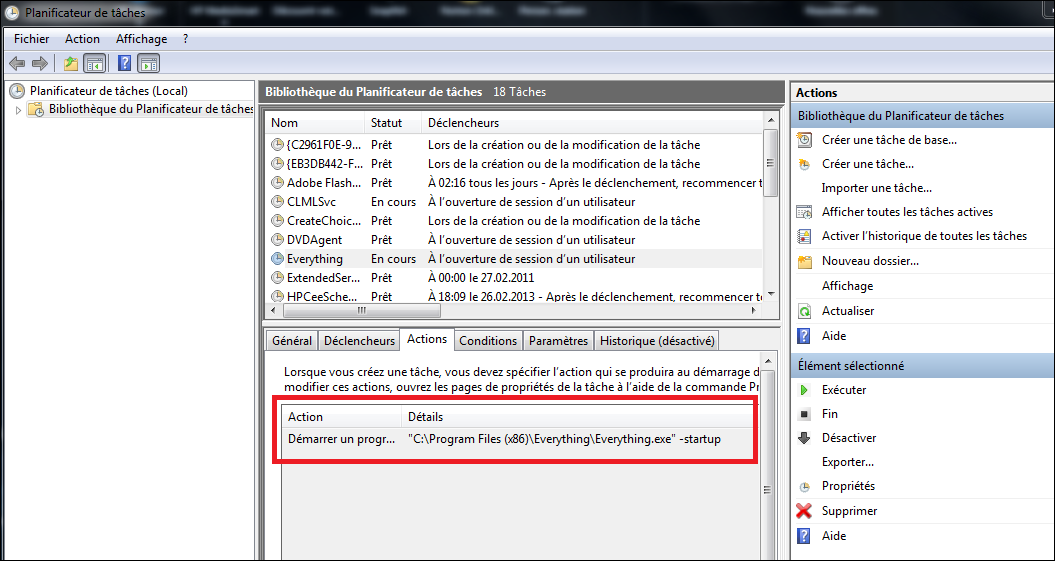

  3. Thanks Geej! Yes the Task is created on my computer with Windows 7 x86. However I put the Everything_Schedule.bat on a diet and works on Windows XP and Windows 7 x86. On Windows XP the task is created but the icon doesn't appear on the task bar ? Maybe you can add inside the Everything.inf the task command for Windows XP ? Everything_Schedule.bat ::*******************************************:::: Everything_Schedule.bat :::: Set variables TaskName, Task and go ahead :::: http://myunster.com]http://myunster.com ::::*******************************************::@ECHO offREM Set variablesSET TaskName=EverythingREM Following task will be executed on Logon:: Detect OS bit-ness on running system.:: Assumes 64-bit unless 64-bit components do not exist.SET "ARCH=64"IF NOT EXIST "%SystemRoot%\SysWOW64\cmd.exe" ( IF NOT DEFINED PROCESSOR_ARCHITEW6432 SET "ARCH=32" ) ::Begin install IF "%ARCH%"=="64" ( SET Task=\"C:\Program Files (x86)\Everything\Everything.exe\" -startup ) ELSE ( SET Task=\"C:\Program Files\Everything\Everything.exe\" -startup )REM Determine windows versionFOR /F "tokens=2* delims= " %%A IN ('REG QUERY "HKLM\SOFTWARE\Microsoft\Windows NT\CurrentVersion" /v "ProductName"') DO SET OSVer=%%BECHO %OSVer% | FINDSTR /I "XP" >NULIF %ERRORLEVEL% == 0 GOTO ver_xpFOR /F "tokens=* delims= " %%A IN ('REG QUERY "HKLM\SOFTWARE\Microsoft\Windows NT\CurrentVersion" /v "ProductName"') DO SET OS=%%AECHO %OS% | FINDSTR /I "Vista" >NULIF %ERRORLEVEL% == 0 GOTO ver_vistaECHO %OS% | FINDSTR /I "7" >NULIF %ERRORLEVEL% == 0 GOTO ver_7:ver_xpSCHTASKS /Create /TN "%TaskName%" /TR "%Task%" /RU "SYSTEM" /SC ONLOGONGOTO exit:ver_vista::Run Windows Vista specific commands here.GOTO Elevation:ver_7SCHTASKS /Create /TN "%TaskName%" /TR "%Task%" /SC ONLOGON /RL HIGHESTGOTO Elevation:ElevationREM Don't forget escape double quotes for CMD argument that you will pass to powershellPushD "%~dp0"IF EXIST "%~0.ELEVATED" DEL /F "%~0.ELEVATED"SET Argument=SCHTASKS /Create /F /TN \"%TaskName%\" /TR \"%Task%\" /SC ONLOGON /RL HIGHESTSET ELEVATED_CMD=PowerShell -Command (New-Object -com 'Shell.Application').ShellExecute('Cmd.exe', '/C %Argument%', '', 'runas')ECHO %ELEVATED_CMD% >> "%~0.ELEVATED"CALL %ELEVATED_CMD%DEL /F "%~0.ELEVATED"PopDGOTO exit:exitEXITSFX file updated on Mediafire for testing.Thanks and regards

  5. Yes, you're right Geej! I did not pay attention but the Task Schedule isn't created. Testing the new one you gave bphlpt (post #95) and doesn't create the Task Shedule. Thanks and regards File on MediaFire updated with previous Everything_Schedule.bat working...But can be improved!
  6. @bphlpt Tested your modified batch file and works really fine and it is faster than the previous one ! :dribble: Tested and works flawlessly on Windows XP 32bit and Windows 7 32bit and 64bit (without using xml file). Just needed to change the comment to: . @Geej Could you try the batch file given by bphlpt, please. File (SFX) updated on Mediafire for testing and including batch file's bphlpt ! French used Cheers and regards

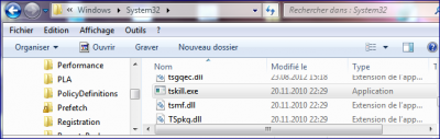

  21. Strange, because I have no errors installing or uninstalling EverythingSearch.exe (SFX file) ! *Edit: You uninstall from Add/Remove programs ? As Geej asked you, look at C:\Windows\system32 to find tskill.exe
