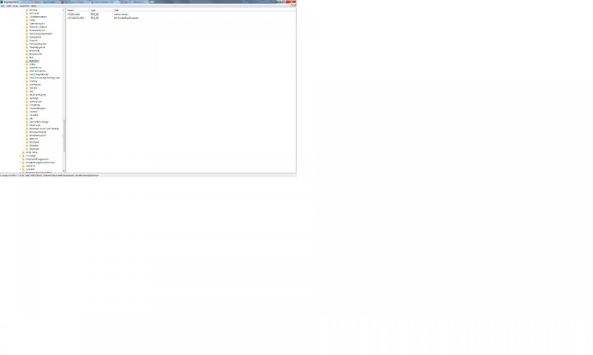

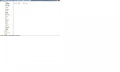

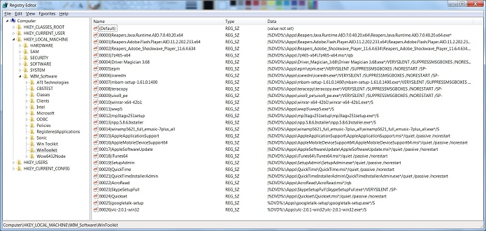

  6. Didn't understand "'export' the RunOnce and WinToolkit registry keys within WIM_Software" Can you please help me step by step instructions as I am a newbie in this? I will create a boot dvd and then load it onto a bootable USB. What extra do I need to do here??

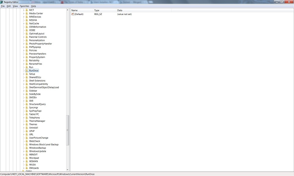

  7. Oops couldn't understand the first time!! Here you go!! One more if this can also help you!!!
  8. I made the USB bootable using the option "USB Boot Prep" and then copy pasted all the contents of the DVD, which was created by "All-In-One Integrator". Attaching the screenshot of the registry as required. Also can you please elaborate on the spaces you are talking about. Are there any spaces in the name of the EXE?? I dont see any space in my folder structure and not even in the Apps folder created in the DVD directory of Win 7. Also just wanted to let you know that the display problem is now fixed with latest version 140-25 and I can see all the option in one screen now.
