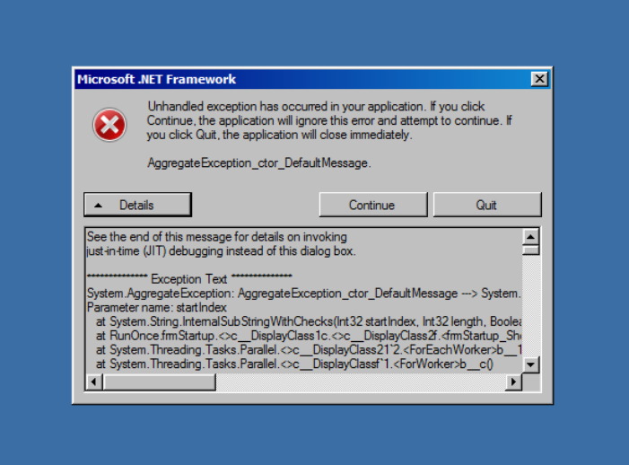

I have net frame work 4.5.1 installed. I ran the run once from my computer that is fully updated with all of windows programs. the one i used to use win toolkit. even this computer is getting an error but i have a screen print
post-56729-0-21650100-1400001926_thumb.p
Edited by John Bruce Nicholson

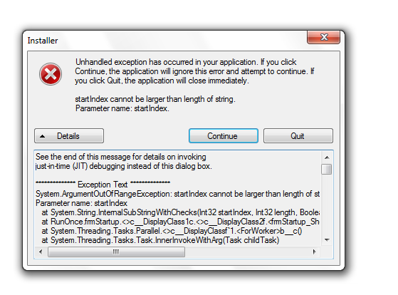

I ran a new install. from a new iso. my local pc has net framework 4.5.1 installed. I integrated drivers, a theme pack, updates and 13 silent installers. i checked in virtual box and it worked. I installed it on my hard drive and i got the error again  here is the screen shot from the freshly installed windows 7 pro 64 bit
here's  the preset ini file
session.txt
post-56729-0-50282100-1400037956_thumb.p
