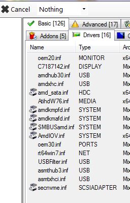

If you import the drivers directly in WTK/Drivers-TAB (I mean from my drivers-folder) they get a small icon in front of the line: if you go with the mouse on those marked lines you get a info-box with a MD5 and the info, that the driver will be installed in the boot.wim too.
But, and this is a bug in my opinion, if you use a WTK.ini to import all your settings (Drivers and checked boxes under "Options" are listed!) the checked-Boxes under "Options" have no effect and the drivers are not integrated in the boot.wim!
If you remove all the driver from the TAB and reload them importing a driver.ini (Load Drivers in Preset-Manager) then it works: the drivers get this small icons in front of the line (depending on which boxes under Options you checked) and are integrated in the boot.wim too.
