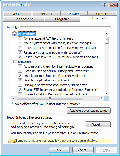

Also, while i'm reporting errors, if you open up the Internet Options, then go to the Advanced tab, you will see graphics that are off the dialogue box. Also the deleting files animation is not fitting the dialogue box, try deleting your temporary internet files to show this up.

i just formated last night and i have to say i have 0 issues,the advanced internet option is ok,i havint had enough temp file to see an animation...so i dunno for that ,and my boot screen is ok.what update pack addon r u using?
edit:
and are you using a very small screen resolution or custom font size dpi?

Hi bober, this is what I get when I open my settings page...
I'm using the 1.0.0.5 version, downloaded a few days ago. I will try and get a screen shot of the delete dialogue box later. It looks like the box is wider than the animation, or the animation is off center perhaps. And also I don't have any hotfixes at t=13, that I know of, but that is something that I will have a look at, just in case!

ah so i see from the screenie that this only appears if someone is connected on a non-admin account?
edit: i found where to fix the internet option dialog, now,ill wait to update till you find the other dialog to resize.i might add new oobe themes to match the version of xp that a user has,while im at it,does anyone know other files i should edit to mach xp home or mce ?
edit:ok i think i found the browser deletion dialog(was in the same file)im not sure if i resised it big enough:
