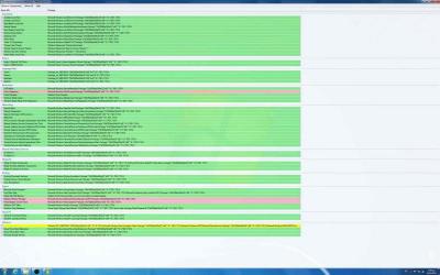

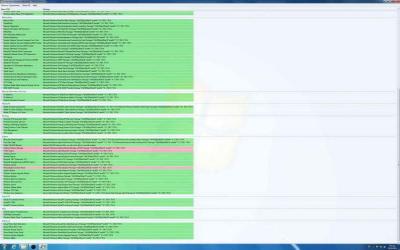

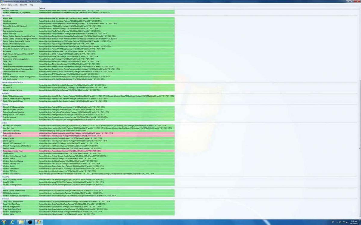

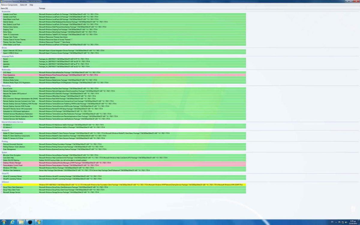

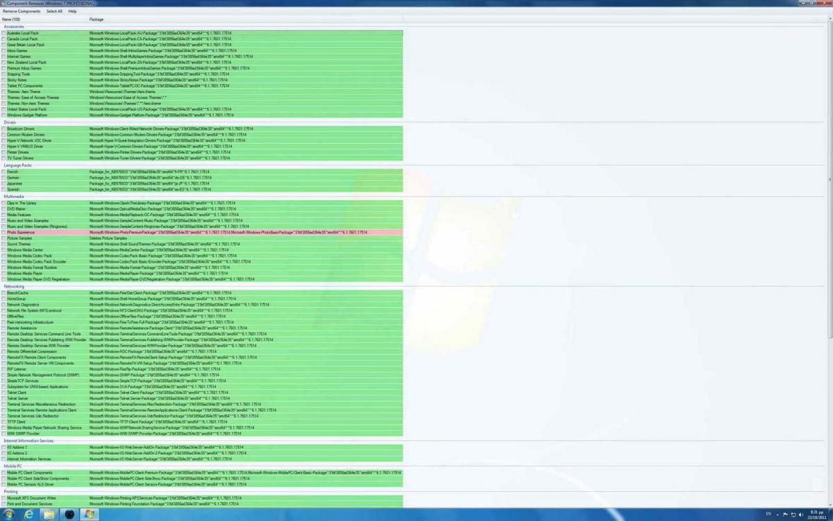

In the manual component remover I see different package list from two different untouched iso's. Is that normal?
Also when you try to remove for example the "Inbox games" component and the program warns you that "removing this component also will remove..." etc, these warnings messages are not working in the x86 part.
