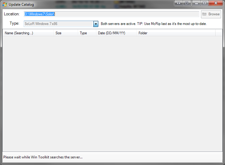

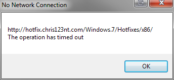

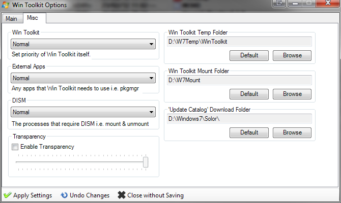

  12. Sure, boss... First the settings (I already removed spaces from download folder name just to be sure) Then I start the update catalog and select SoloR Windows 7 x86: After some time I get the time-out: and then this message: I hope this is of more use? I get the exact same behaviour for McRip.... Regards, Eric666
  13. Well, I still have the same problem with v28. I've even removed my settings.txt file and had it made anew by WinToolkit, but to no avail. When I start update catalog, it just times out. I've also chosen a download folder without spaces in the name, but also that didn't work. Regards, Eric666

  15. No, when the ini-file is rewritten using v26, the trailing backslash in the path is not there and everything works OK. But in the ini file made by an older version there is a trailing backslash which is not handled well by v26, causing the problems I described above. Seems like a simple check, just handling the backslash when it is found in the path. Regards, Eric666

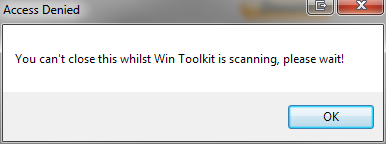

  16. Hi, I've been trying to use the update catalog feature for a few versions already but it gave me every time the message http://chris123nt.com/.. The operation timed out. After closing this dialog a new dialog appeared: Access denied: You can't close this whilst Win Toolkit is scanning, please wait! I saw in some other thread that the servers of McRip and Solor would be down. I checked using an ordinary webbrowser and both appeared to be up! I finally solved the 'connection' problem by resetting the Update Catalog Download folder in Win Toolkit Options (defining the same path as before!). So it seems that somewhere during development the path (from ini?) has become unreadable and messed up the update process? Further investigation: in the old settings.txt the path has a trailing backslash, where this is not the case in the newest version. At least there is a quick workaround, but could you take a quick glance into this Lego? Regards, Eric666
