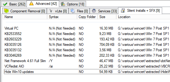

Ouch.. I got some errors: "The service cannot be started, either because it is disabled or because it has no enabled devices associated with it." - at runonceex --> W10.vbs - in Event Viewer --> all the 7 KBs that were in the SFX section :doh: Is it because I disabled Win Update Service from WinToolkit? (I wanted to avoid surprises). I didn't know that it had to run.. 1- Can I just launch then manually or should I just reinstall the entire OS? :sad01_anim: EDIT: oh well, I ran them (however, W10 and KB2533552 needed to be online). Solved, I guess. 2- Can I easily fix the current ISO + USB without restarting all the process? P.S: I noticed some active telemetry tasks. Are these defaults or some evil KB slipped through your selection? P.P.S: other 2 small errors in Event Viewer: - NetRuntime Optimization 1130 (NetFrame addon didn't start the service?) - WMI error 0x80041003 (ISO creation issue?) P.P.P.S: Win Toolkit used Autounattended.xml, but ignored my key.

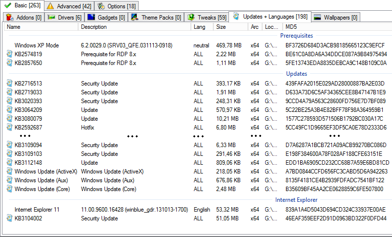

Ah, that seems more clear now, thanks. You should really add this info to the first post\readme, unless I'm completely blind. I've started the process again. Also, here are 2 screens (edit: woops, update "Z" missing) P.s: btw, the program shows some error sometimes (eg: tweaks->custom explorer bar, unattended->accept eula) EDIT: also during the integration, so I had to restart. Probably it didn't like "run as admin" and\or folders inside the user path.

Ok, I've added the .exe but now the .msu counterparts are missing. I need to add them manually to the SFX section, right? This part is really confusing..
