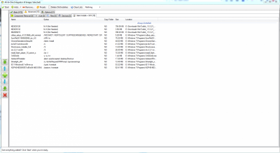

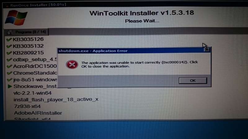

  1. Hi All, I've been very excited playing around with Win Toolkit this week, and although I've hit a few brick walls and a few speed humps I've been streamlining my install image to become an ultimate tool. My current problem is more of a nuisance than anything else, but I'd love to get it resolved to complete my 'full Windows 7 install' experience! I've integrated all General, Security and Hotfix updates and integrated x64 and x86 images to have a complete A-I-O installer, the latest problem I've had though is that during the Win Toolkit Additional Installers section I am getting an error referring to 'shutdown.exe' (I will run it again and get the specific error and update this post when I do) during install of Shockwave which causes the system to initiate a restart and skip my remaining silent installers. I have never had to reboot after installing Shockwave before, the update before it was Java which may be causing the reboot perhaps? I have attached a screenshot of my silent installers and their switches hoping I may just need to adjust a switch slightly to complete the rest of the installers as intended. Any help is MUCH appreciated!
  2. OK, so after a lengthy process of elimination, I seem to have gotten past the error during installation (I only integrated the updates in 'General', 'Hotfix' and 'Security', no additional optional updates and also removed dot net as an addon and am attempting to add it as a silent installer). I have another question now though.... Is it possible to 'edit' or 'remove' Silent Installers after they have been integrated? After getting the updates integrated I added about 6 'Silent Installs' to my image. It appears that a switch on the 3rd or 4th installer may be incorrect and causes an error with this install, followed by a reboot and continuation to desktop skipping the remaining installers. I was hoping to 'edit' my silent installers to avoid having to rebuild my entire x86 and x64 images again (takes approx 4 hours for each!). If not, is there a .ini file or similar in the install directory where I can edit the switches? Thanks in advance again!!
