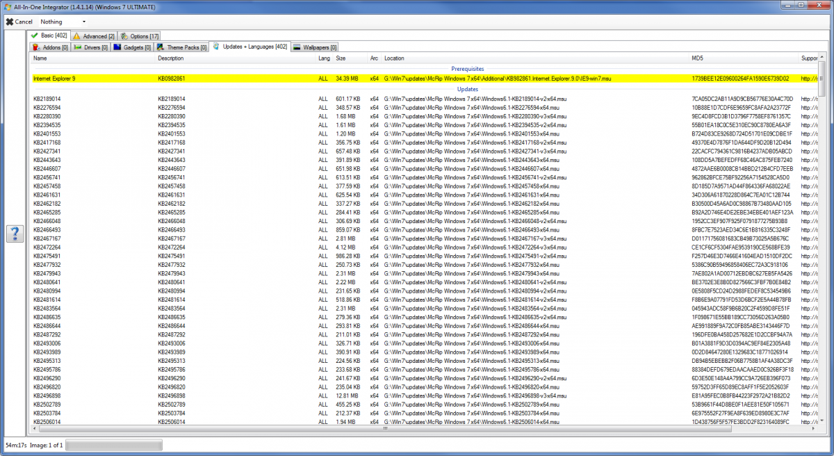

I have a possible issue/bug with WinToolKit.  I am using 1.4.1.15_test15.  I was attempting to integrate just updates into a source.  The first update listed is KB2670838.  On the status bar, it says "Image 1 of 1" with no green showing on the bar.  It has been stuck in this mode for at least an hour (even after attempting to cancel the integration).  Any ideas?  Integration ini included below.
After further testing and another post, it does not matter what prerequisites are integrated, WinToolKit stops as the first one and does not appear to continue.  Just basic updates integration and nothing else.

Coming right up. (As I left it running for a very long time.)  Please note that this is on a fresh installation of Windows 7 (had a power supply crash) with no antivirus (yet) or any other programs installed.  Literally just the basics.
post-11322-0-82494100-1360455449_thumb.p
Yes, it appear to have mounted the images.  It also show information about integrating the first prerequisite for about 20 seconds.  Then, it has been stuck at the screen you see attached above.  It would not even properly cancel (at least not soon enough for me, because I have no idea how long it would take to cancel).

Not to cause this problem bphlpt. I have tested everything out. The OS is now stable (after a reinstall), and there does not appear to be any other issues. I have "reloaded" the source files before starting the integration. This is a consistent problem even back to earlier test versions. I have not attempted a stable version yet (although I probably should try that). WinToolKit will consistently freeze up right at the first update file.
Edit: Further testing reveals that this problem does not occur using the latest "stable" version 1.4.1.14. It is currently working on updates now.
Edit 2: The "stable" version 1.4.1.14 took 2h 17m even on an SSD.  Not sure what is up with that, but at least the stable version works.  Still cannot get the test version to work.
