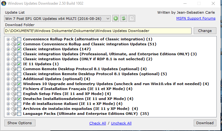

OK, to make communication easier I attached what updates I donwloaded.
Could you plz tell me if thats all I need to have my German Up-to-date-Version of my Windows 7 (Im going to include only home+professional, so I think I wont have problems with install.wim >4GB)
Also I would be really happy if someone could tell me which updates I should move to prerequisites and how I can integrade the internet Explorer11, that never worked for me. Also Im unsure if I really should move all updates to silent installers if wintoolkit tells me so.
greetz revnu

11 minutes ago, revnu said:
EDIT: SRY I did not see it, but it is described on that site what updates to load. Im now going to integrade, but im still unsure how to integrate IE11 and if there is anything I should change in wintoolkit (prerequisites, etc)
No problem!
What you selected is correct, but
1) I don't select Win10 (Win7 forever :D)
2) I use the Convenience Rollup Pack and not the Classic.
Prerequisite: I set KB3020369 and KB2670838
IE11: First the IE11 itself in the sequence and then the update
How do you integrate the updates only for HP & Prof?
Schöne Grüße aus Tirol, Thiersee
28 minutes ago, revnu said:
but I think "common Conveniece Rollup" is that big Updatepack in single patches
This is not correct, it is not the same: both satisfy WU, but the integration/installation-time is shorter, if you use the Convenience Rollup (and accept the sfc error).

I just added all Updates in wintoolkit. It moved 4 to silent installers (KB2533552, KB2603229, KB3020369, KB3046269). 2 Updates it moved to prerequistes (KB2574819, KB2857650).
one update is moved to "internet Explrer" (KB3175443, 52MB)
The IE11 install file itself (IE11-Windows6.1-x64-de-de.exe) is not in list, do I have to add this in some other kind of way? And do you know if all updates are in correct lists now?
greetz revnu
What did you download under "Deutsche Installationsdateien" ?
I only have IE11-Windows6.1-x64-de-de, the others I unchecked, as the WindowsXPMode_de-de.exe is 400mb and I thought that I dont need the others. But I can get them all in list if I have to, because I think I have enough space not because I kicked homebasic & ultimate
EDIT: I tried it. this update gave me an unknown error "4-Windows6.1-KB3172605-x64.msu"
