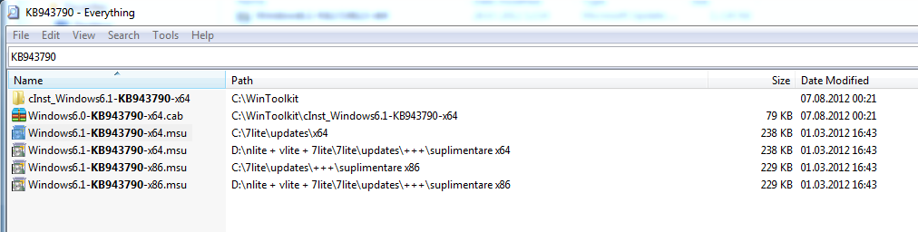

  13. Hmmmm... I didn't verify at first if the KB943790 was really vista (6.0) only, I got ashamed when I saw you explanation, however I really don't have any KB943790 for vista on my hdd, only for 7 (6.1). You can see attached a screenshot from Everything (a cool search tool). However, Win Toolkit extracts that 6.0 version from the 6.1 .msu (???). I swear if I must that the .msu integrated is the 6.1 one from the C:\7lite\updates\x64 location, and I'm not in the renaming .msu's period. Twilight zone bug Please investigate.
