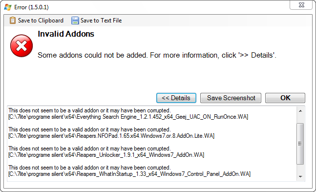

		v1.5.0.1_t20 Addon problem
		Same error in beta / test 22.
		Same error in beta / test 21.

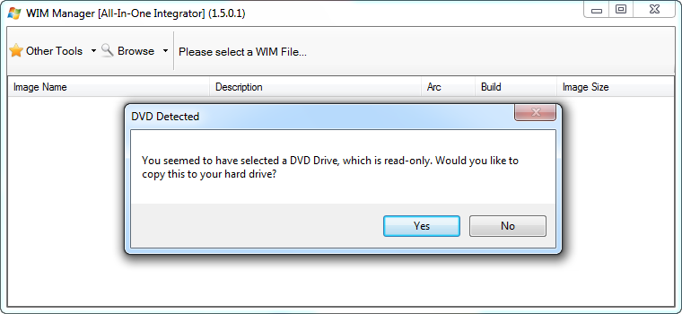

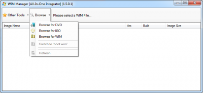

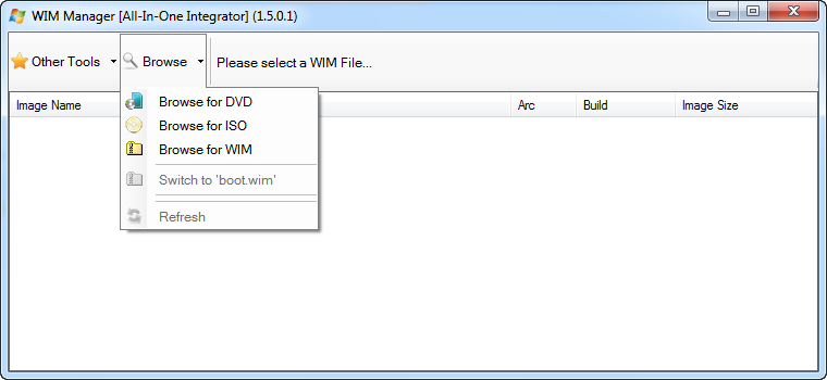

		This is solved in test 21. Selecting DVD and directing to the folder on my HDD is ok now. Problem solved. Optional / Idea: Maybe however a name change from ''Browse for DVD'' to ''Browse for DVD / Folder''?
		[Solved] AIO 1.5.0.1_t20 issue
		Where is the ''Browse for folder'' first option in AIO? See attached the new interface. Also, if I select DVD, it gives me the second attached screen. WHY??? To select it manually and not have to write the already copied content form my hdd once more to another location, WIM option is the only option for me.
