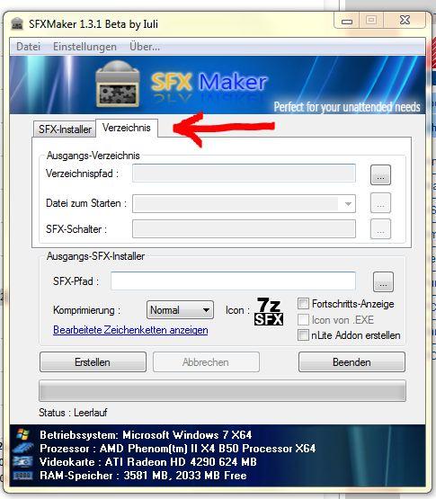

Thiersee Posted February 20, 2013 Share Posted February 20, 2013 For example i have Microsoft Navision (setup.exe and a Classic.xml)To install silent i use (/quiet /config Classic.xml) that works while testing on a running system. If I remember well, I have already given you the hint: put all the files for a program (in this case setup.exe and Classic.xml) in a folder, try to make the silent-installer with SFXMaker/Folder (Verzeichnis)Path (Verzeichnis): the path you put the files inDatei zum Starten (File to start): your setup.exeSFX-Schalter (SFX-Switches): /quiet /config Classic.xml Regards, Thiersee Quote Link to comment Share on other sites More sharing options...

x23piracy Posted February 21, 2013 Author Share Posted February 21, 2013 (edited) Hi, If I remember well, I have already given you the hint: i use that tool sorry if that info was missing. setup.exe and switches are /quiet /config Classic.xml but as explained that doesnt workif i use a batch infront of the setup.exe it works. Greetz X23 Edited February 21, 2013 by x23piracy Quote Link to comment Share on other sites More sharing options...
