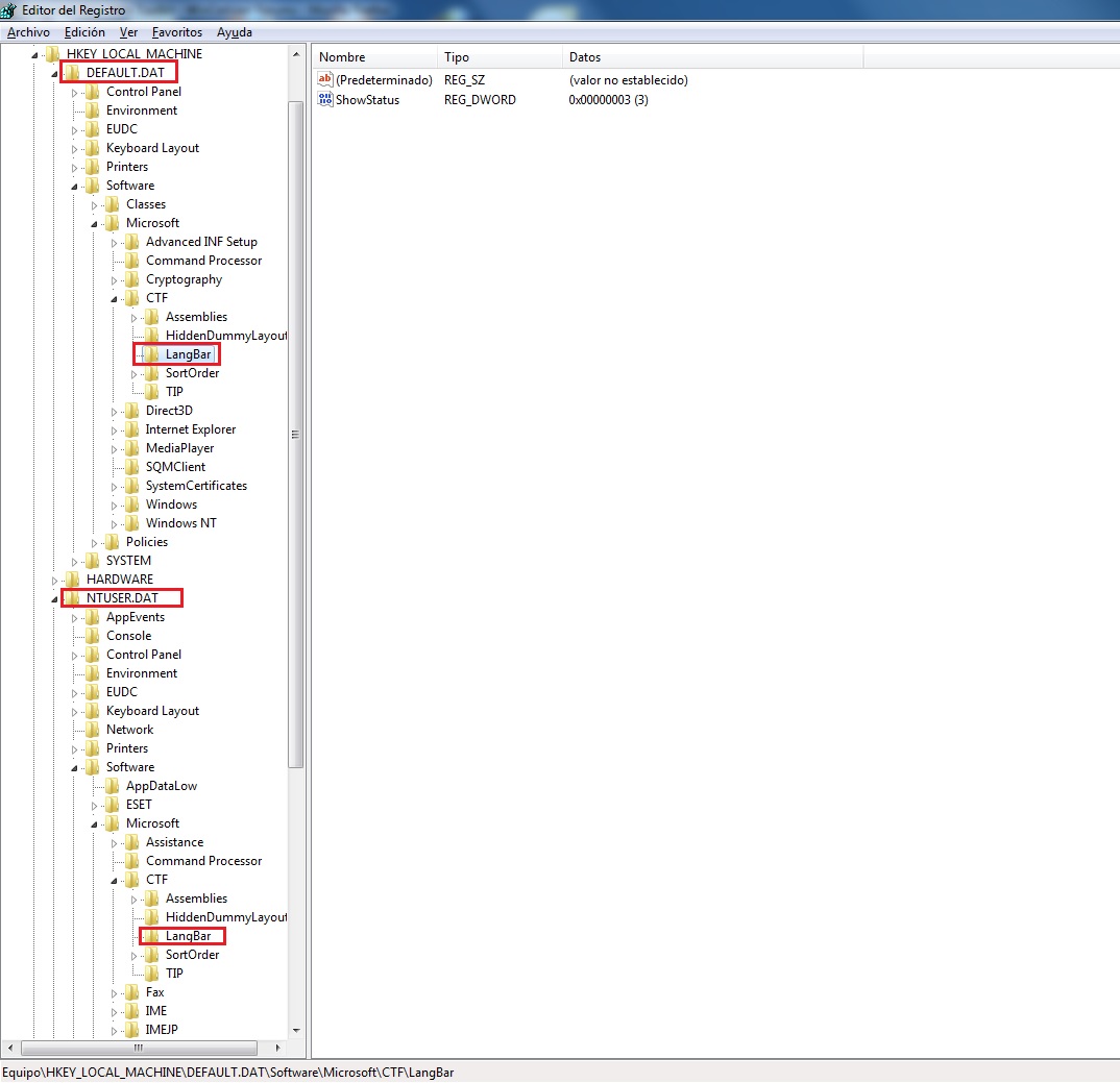

I load NTUSER.DAT and DEFAULT (not DEFAULT.DAT) hives (from Mounted Image) in Regedit to manually add "ShowStatus"=dword:00000003 in [software\Microsoft\CTF\LangBar]...
Regards...;-)
p.d.: I think so Win Toolkit added reg data only to NTUSER.DAT, but not in DEFAULT wich it's for ADMIN USER (or DEFAULT USER)...
post-27023-0-09619200-1362601417_thumb.j
Edited by alfreire
Regards...;-)
Thanks alfreire...I will make some tests!
*Edit: However we can see on your image that the hive DEFAULT.DAT is loaded !?
Regards...;-)
I've done exactly this and it's not working for me.
Greetz X23
Edited by x23piracy
