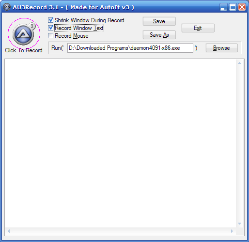

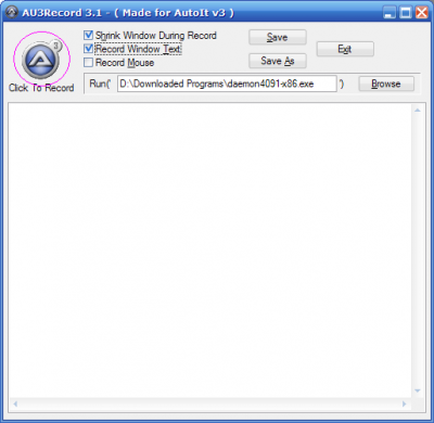

u will see this :
1- select the installation package which u r going to make the script for , it shall be an EXE which the script will call each time it runs ..........
2- make the check boxes , as made in the pic
3- click the "A" button
once we click the "A" button,the exe(which is the installation package) we specifed will run, and every movement we make on our pc using the keyboard will be recorded,

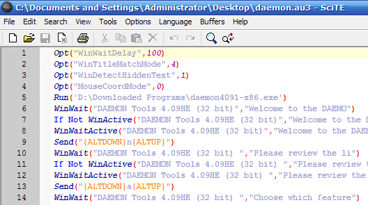

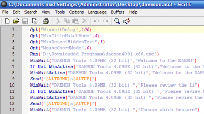

After u completly installed the application , we have to stop the record operation by clicking the "A" button at the upper left of the screen , now u must see some code written like this ....
Now , we have to add little code to our app , to avoid hassles , and running same application again and again
$SF_1 = "app.exe"
If WinExists ( $SF_1 ) Then Exit
AutoItWinSetTitle ( $SF_1)
** u may ask , what is this attented for , the answer is , this code is just a safety measure during the testing period , i once used a script which don't have this code (or similiar) and a big trouble occourded , the compiled EXE kept running it self again and again , and at last , 101 process where running on my poor pc :no: , i used taskkill to
get rid of those processes and i succeded :thumbup

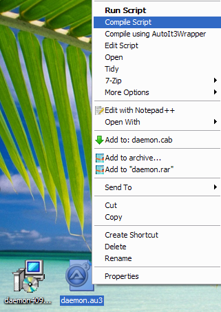

replace app.exe by the installation package exe u selected when recording the script, now save the file near by ur EXE package as u see in the pic , then compile the script ....
NOW all is done we have the compiled EXE , try running it now , u will see every thing in the setup going automatically
