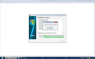

  • I am still getting this error: I used XPtsp_v3.0.0.26_GUI.exe and selected the following options: 1.Integrate in a Windows Xp Source (Offline Mode) 2.Chose MSDN XP SP3 + XPSP3_QFE_UpdatePack Post-SP3
