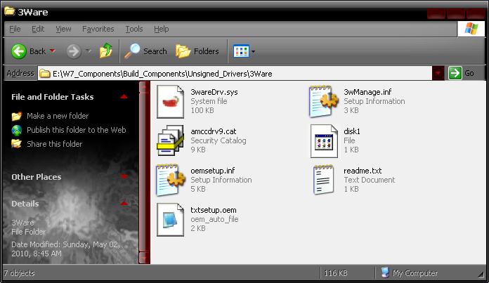

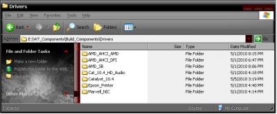

ricktendo64, I attach a screen shot of my driver folders being injected. These are all signed. I am also injecting 3Ware RAID drivers that are unsigned. I pointed dism to the unsigned driver folder and did not specify individual inf files. Looking in the INF folder afterward show that both the inf files were picked up. I am really wondering why VMware is having any kind of driver problem when it should not be using any of mine at all. My plan is to see if I can get my AutoUnattend.xml errors out, then try to determine which driver(s) is causing the 07B. Thanks, John.
I have never seen this or even similar issue.

ricktendo64, I removed 4, then 2 more, then 1 more drivers. I ended up with only ATI HD Audio (Cat_10.4_HD_Audio) when the install worked. The last one I removed was ATI PCIE (AMD_SB). Tomorrow I will add all back in but this one and see if I can install. I attach the inf file for this one (renamed to txt file). Thanks, John.
ATiPCIE.txt
What you need to do is install Win7 with little or no drivers, then install your drivers like you normally do, then use a proper tool to back them up like Driver Max, Driver Genius or DriverBackup by IcemanND and integrate those backed up drivers to be sure that they are properly done
ATI video drivers are weird that way, multiple files with the same name in different sub folders
