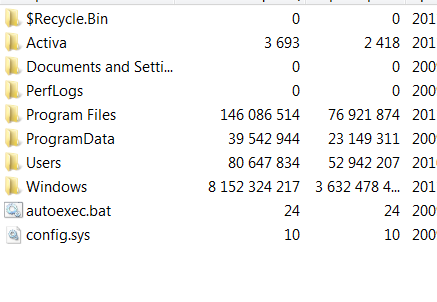

Well I spend my whole afternoon to create my perfect dual layer DVD for both my win 7 PC's but I did not make it..
My problem is that the original's DVD wim structure is:
post-13922-0-50326400-1309123246_thumb.p
And if I delete ei.cfg (and keep only Ultimate & home premium clg files will that work???)I'll get the perfect DVD which installs Home premium in my laptop & ultimate at my desktop I guess...

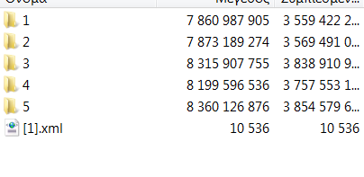

But after updating the image with latest updates I get this structure which means only ultimate...(Tested)
post-13922-0-29882700-1309123267_thumb.p

You just export the home premium image into the same install.wim that only has ultimate and you will get folders #1 with ultimate and #2 with home premium
Use the command you used to export only ultimate but this time make it home premium index number (where you see # you change that to the image number you want to export) and tell imagex to export it into your wim with only ultimate (it will make a 2 in 1 wim)
imagex /compress maximum /export <path_to_original_wim>\install.wim # <path_to_new_wim>\install.wim /check
