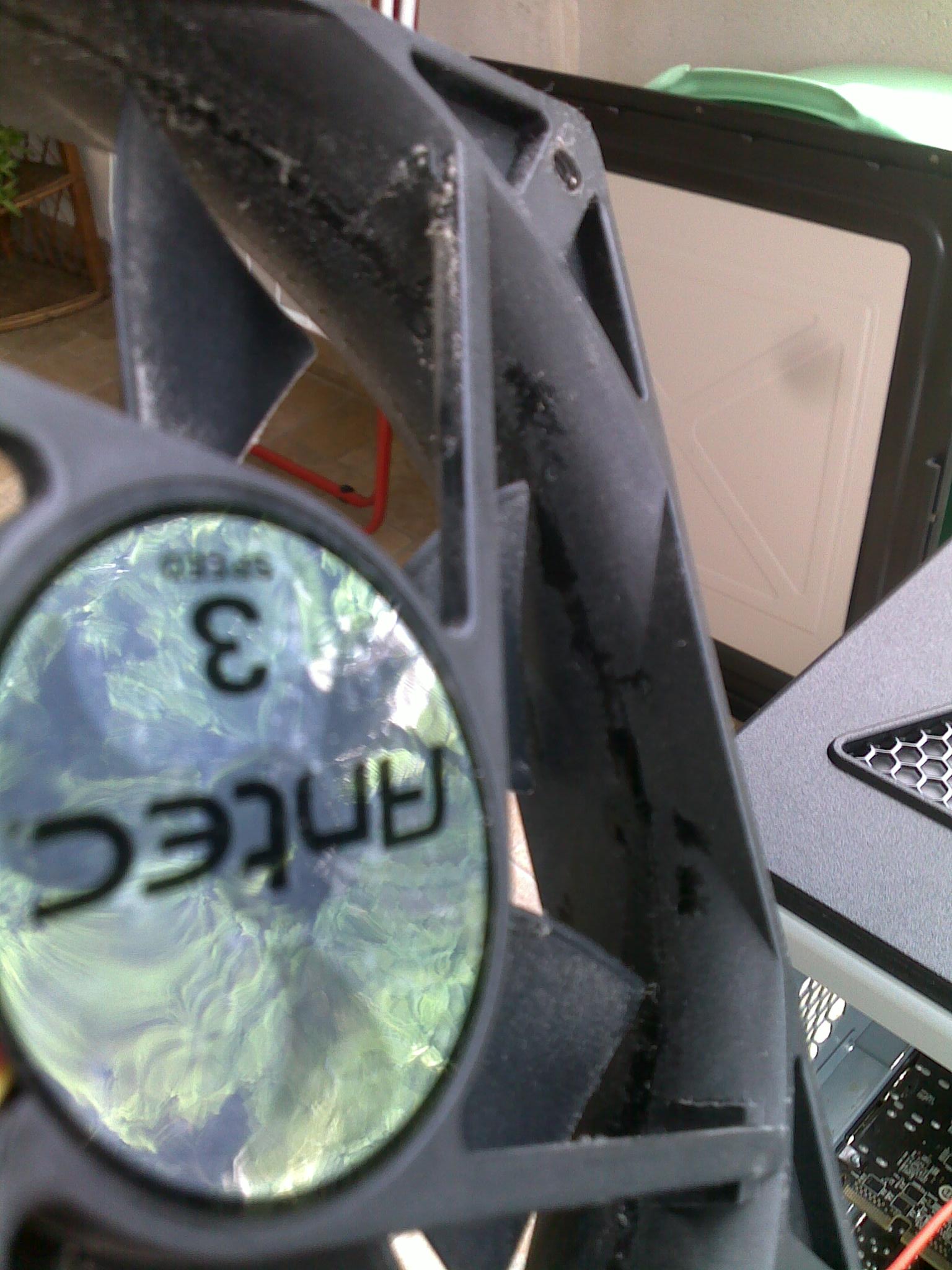

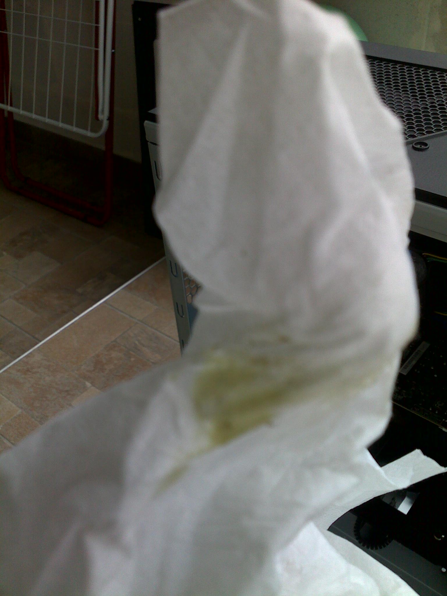

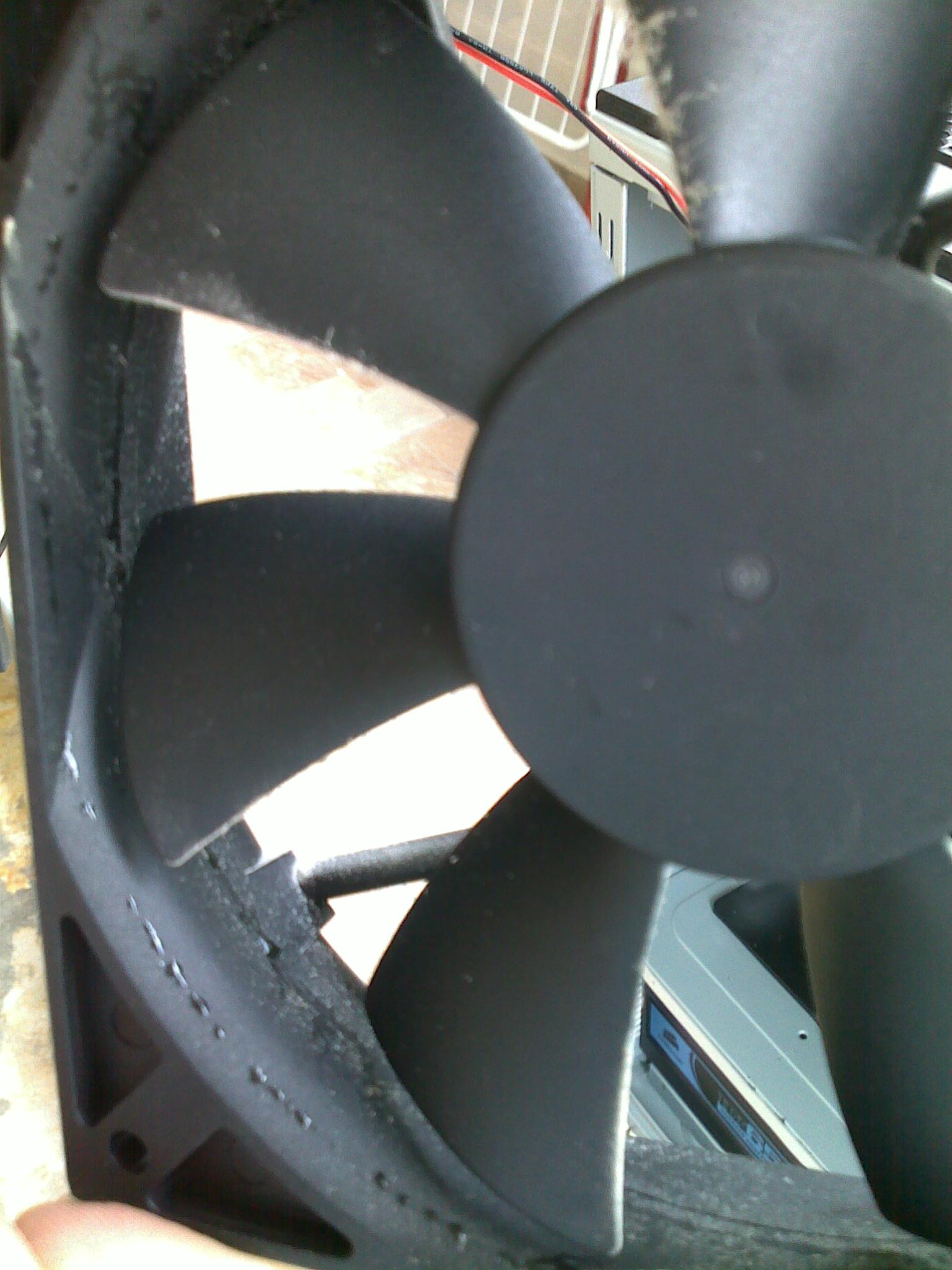

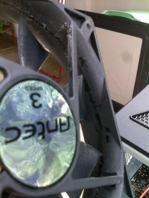

Also, I have noticed an oil on my both case coolers. Since my camera is currently borrowed, I've took a picture with my cell phone and will post it later on. Should I return those to the store and ask for another set of case coolers.I will post pictures in about an hour.
Here are the pictures of coolers, along with the tissue that I've used to clean those coolers. Looks like an oil to me.
Yup, that's definitely oil. If you hear the affected fans making a "growling" noise, definitely take them back to the store (you might get lucky and they'll swap them out).

Thanks! Since I have cleaned the fans now, I should wait for the next round of oil leakage :) BTW, there is no growling sound, but the chassis seems a bit louder than the first time I was using it.

BTW. I've sent a mail to Antec support to see what they will have to say about this oil leakage.
