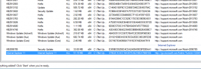

False alarm. Yes, once the integration process is initiated, the IE11 cab goes on top of its ''postrequisites'' category. So it wasn't a bug to begin with

See attached. I use the .cab version of IE11, but by default it isn't at the top of the ''postrequisites'' area. This isn't ok, especially if WinToolkit preserves that order when integrating). I noticed it and I used the arrows to move the IE11 .cab above its update. LE: latest beta 9 of 1.4.30
