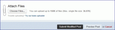

4)What is the format allowed for the image in this forum. I've tried .jpg and .png and it does'nt work.
%USERPROFILE%\Documents\test.doc
Using %userprofile% path doesn't work and the folder %userprofile% will be copied inside WinToolkit140-77
You can use gif files format to post images inside the forum. Thanks.
Sorry, i can't post image
"You are not allowed to use that image extension on this community." I use gif...

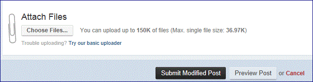

Strange about adding images, because I can attach jpg, PNG and gif images format.
Maybe you need to check the size for downloading the images (150K max.) using full editor or more options and select an image on your computer?
Of course, don't change manually the extension format!
post-23163-0-82763600-1352482725_thumb.g
