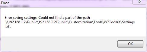

Looks like something went a bit haywire...older versions work fine...
post-3142-0-58811300-1355911593_thumb.jp
Looks like WinToolkit cannot find its settings file anymore, when you run it from Network Share.
It also creates folder with the very same path, to Network drive root...instead of using settings file from its own folder.
Still wondering, why it duplicates first two directories in path now... :g:

Nothing special, just launched it...
As I always extract it to the very same folder, settings.txt definately exists there.
Also 1.5.x is affected the very same way....
Doesnt occure, when you run it from PC/Laptop local drive...

Sounds like a UNC resolution issue.  Possibly an undocumented "bug" with windows?
But it worked just fine, untill last version... :g:
Also I cannot reproduce it with 1.4.0.77 for example.

Strange thing is, I haven't changed any of the save code. I have managed to reproduce the problem, but it's strange :/
While I do not know how you have it programmed, maybe something has changed in the function calls to resolve filename setting locations?  Could be a bug in the programming language you use.
Just for confirmation, still exists in 1.4.1.3 and 1.4.1.4
Only Error message is somewhat longer...and no excess directory (192.168.1.2) is created to Share root anymore.

Could you explain it a bit more detail, what actually broke that suddenly, I`m a littlebit curious... :P

Can confirm, its fixed now :)
Also, as sidenote... Downloading Extra Content doesnt crash it anymore...
Tested on 1.4.1.6
