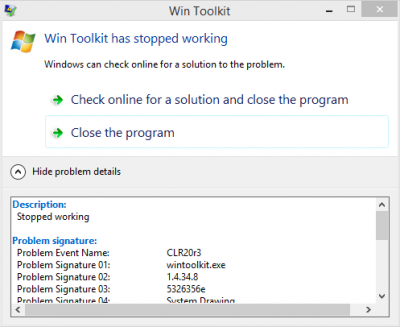

Unfortunately cannot test it, as latest Testing version (Test 8), just refuses to run :(
Description:  Stopped workingProblem signature:  Problem Event Name:    CLR20r3  Problem Signature 01:    wintoolkit.exe  Problem Signature 02:    1.4.34.8  Problem Signature 03:    5326356e  Problem Signature 04:    System.Drawing  Problem Signature 05:    2.0.0.0  Problem Signature 06:    520b1a3d  Problem Signature 07:    457  Problem Signature 08:    79  Problem Signature 09:    System.ArgumentException  OS Version:    6.3.9600.2.0.0.256.4  Locale ID:    1061Read our privacy statement online:  http://go.microsoft.com/fwlink/?linkid=280262If the online privacy statement is not available, please read our privacy statement offline:  C:\WINDOWS\system32\en-US\erofflps.txt

Try test 10 please :) It should write a log in the system32 folder.

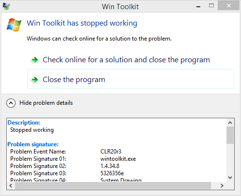

Pretty same result:
Problem signature:  Problem Event Name:    CLR20r3  Problem Signature 01:    wintoolkit.exe  Problem Signature 02:    1.4.34.10  Problem Signature 03:    532735dc  Problem Signature 04:    System.Drawing  Problem Signature 05:    2.0.0.0  Problem Signature 06:    520b1a3d  Problem Signature 07:    457  Problem Signature 08:    79  Problem Signature 09:    System.ArgumentException  OS Version:    6.3.9600.2.0.0.256.4  Locale ID:    1061
Unfortunately didnt find anything WinToolkit related from System32 folder.
What is that log file name?
Basically it instantly crashes, even before the GUI is displayed.
Edited by Etz
Share this post
Link to post
Share on other sites
Ok, found what is causing this problem, as opposite to the Older Stable version, this version doesnt like when it`s being run from Network Drive (Network Share). :doh:
