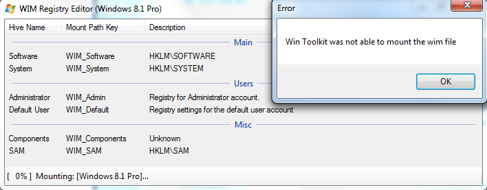

I'm trying to use the WIM Registry Editor to add in my own Reg tweaks into a windows 8.1 Pro x64 ISO and I get the following errors when trying to open the editor:
post-62941-0-38965000-1399538791_thumb.p

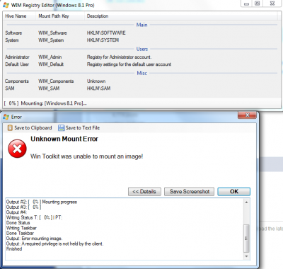

I click OK past that error and get then get this:
post-62941-0-51690700-1399538825_thumb.p

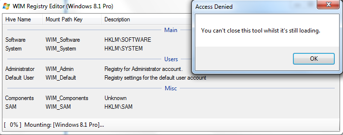

And once more after clicking OK past that I get this:
post-62941-0-61627900-1399538846_thumb.p
And that last one I can't close, I have to kill the process in task manager.
**NOTE** This also happens when I try to apply anything from within the All-In-One settings I get the same Unknown Mount error with the same details of 'A required privilege is not held by the client' - but I can click ok past it and it carries on applying settings (or that's what it looks like). However when I install the ISO on a virtual machine none of the changes are present.
