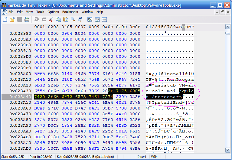

July 3, 200718 yr Hey Rick,I extracted your VMWare Tools 6 cab and ran the executable that was inside SVCPACK alone inside a VM of XP that did not have VMWare tools installed. It automatically, without prompt, forced a reboot...Is there anyway I can get rid of that? Thanks!
July 3, 200718 yr Author I will repack it making sure I used the /norestart switch but I use it during svcpack and never restarted with any of my tests
July 3, 200718 yr I will repack it making sure I used the /norestart switch but I use it during svcpack and never restarted with any of my testsI know your addon was not meant to work this way but try doing what I did and see if it reboots on you...I was using your executable in a WPI install when it occurred...
July 6, 200718 yr Author I just checked my installer switches and there is nothing wrong with it (opened it in a hex editing tool to view the switches used)...So it not my installers fault, might be something you did.
