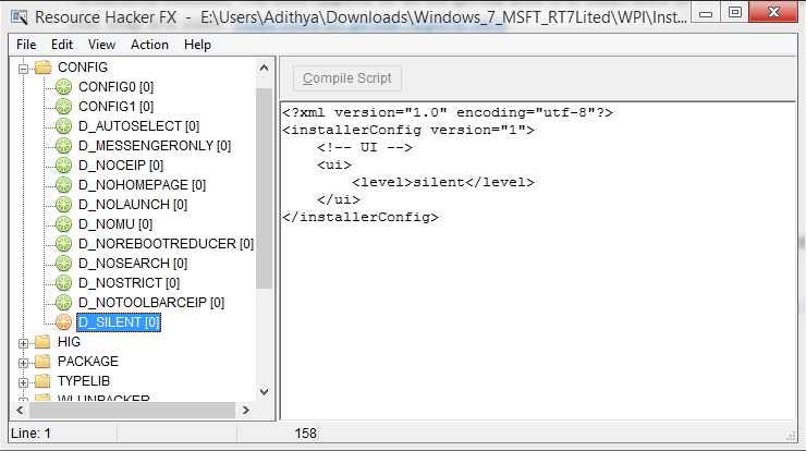

NOTE: Googling silent install switch of Win Live Essentials 2012 shows a silent switch '/q' in most of the websites, which is wrong. That switch is actually for the older version. If this switch is used in 2012, the setup won't open/install at all. Tested myself. Instead of /q, the orrect working switch is /SILENT. If you want proof, open using reshacker, and go to the section 'CONFIG'. All the switches are given there. See this image:
