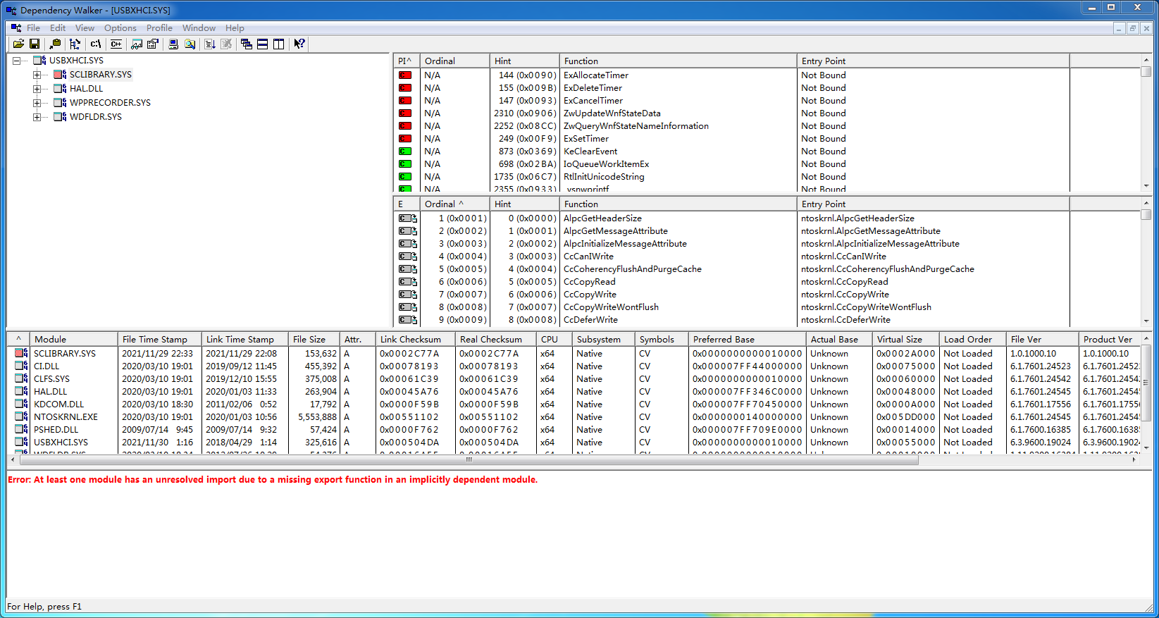

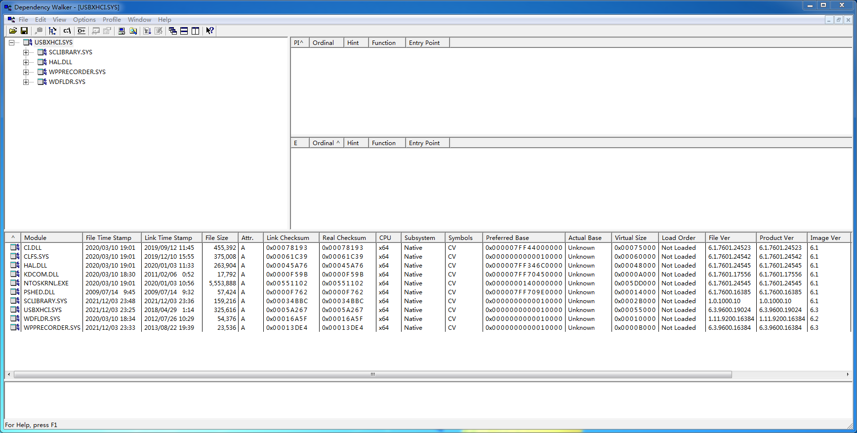

I already porting the usb driver from win8.1 and win10 1511, but they will code 10 error on win7.  What I need to do with the inf file?
Code 10 is common error -  unsupported hardware, unsupported OS, failed internal driver checks, etc...
Driver code starts, but windows receive some error from driver, you can't fix it with patching .inf
And don't forget to remove initial security cookie check, this check, will fail on pre-Win8 OSes
