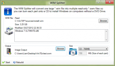

Legolash2o Posted August 29, 2011 Share Posted August 29, 2011 (edited) WIM Splitter is the tool where you can split a large install.wim into smaller *.swm so you can fit your installation disk onto a CD.Step 1: Select the WIMClick the first browse button and select the *.wim file you want to split.Step 2: Choose your 'Size'Type in the maximum size you want each separate files to be.Step 3: Select your 'Output' folderSelect the folder you want the new separate files to go.Step 4: Press startPress start and wait for it to finish Option: RebuildRebuild options literally rebuilds the image so that it becomes smaller which then in turn makes your ISO smaller. This is only needed if you have made modifications to an image. Edited March 28, 2012 by Legolash2o dvgbox 1 Quote Link to comment Share on other sites More sharing options...
