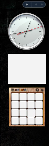

Well, even ricks toys didn't work. Something else is going on. I uploaded a screen. The big white block is the CPU/memory gauge.
Note: All of the requirements are installed BUT WMP11. Is WMP11 a requirement?

    The delay load error is caused by WLan API Hotfix not being installed
If you could include the runtimes and not the wlan api, that would still be an improvement; ryanvm's pack has that included, so if you're integrating that, you're covered. Use booogy's slipstreamer to slipstream wmp11 and you're set!

I have been trying for days to get sidebar to work, until I found this website. Now I have it running, kind of. I have installed IE7, C++2k5 redistr, msxml6, Alky(because I couldnt find VAIO), and .NET 3.0. I can get most of the gadgets to work, but CPU gauges, clock and some others I wouldnt use anyway, give me either white boxes or just dead space on the side bar. I tried to download the RegSidebar.rar, but it turned out to be a .php file that my system wont read. I would love to get this up and running. Thanks for the help.
If you installed the sidebar using my addon or installer you can go to Add or Remove Programs and in the Windows Sidebar uninstall options you can use the Change button to reregister the sidebar libraries.
Manual register commands you can cut and paste into a run or cmd window
"%ProgramFiles%\Windows Sidebar\.\regsvr32.exe" "sbdrop.dll" "wlsrvc.dll"
"%ProgramFiles%\Windows Sidebar\sidebar.exe" /RegServer
Well did you try the manual way of registering?
First make sure you copy regsvr32.exe from %WinDir%\system32 and manifest.xml from "%ProgramFiles%\Alky for Applications\Libraries" copy them to "%ProgramFiles%\Windows Sidebar" and rename manifest.xml to regsvr32.exe.manifest
Then copy, paste and run the commands I gave you above
I did the copy paste, but I dont know how to run the code you listed. Like I said, or maybe I should be more specific. I am a newb.
The reason your clock and other gadgets are not working is you did not register the files correctly, that is what the command do.
Hit Windows Key+R to open Run and paste the first code in it and hit OK (do the same for the second line) or hit Windows Key+R and type CMD hit OK and paste the code in the Command Promt and hit Enter (other CMD shortcut is in Start>All-Programs>Accessories>Command Prompt)
Thank you, I didnt realize it was that easy. Thank you for not being a prick like some boards can be.
It worked.....THANK YOU THANK YOU THANK YOU. :thumbsup_anim: :sweatingbullets: :thumb_yello: :notworthy:
