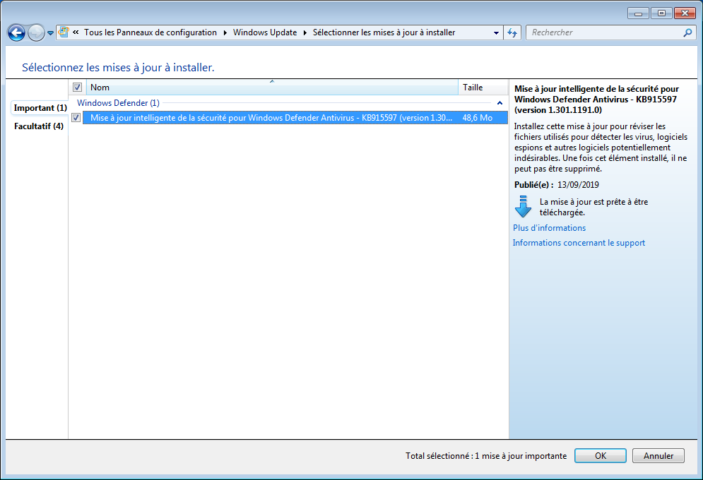

  9. Hello Thiersee, Thank you for the info. Strange thing, I just checked my 4 VMs (2 classic and Convenience method for x86 and x64), and in my case this update is still not requested. Here is the result of WU in my x64 machine. No problem, I'll update ULs. Effectively, reading in other forums, KB4490628 is not superseeded. Once KB4516655 manually installed, Deep clean doesn't remove anything. I'm doing a test integrating KB4516655 in prerequisites updates keeping KB4490628. Some people reported problems with september updates.
