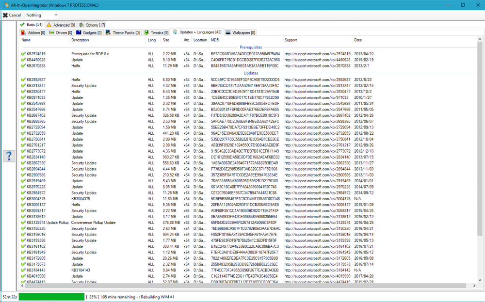

  1. @pennsylvaniaron Actually, only 5 KB are needed to be masked (in the maker kit, in telemetry.vbs file, you can now delete KB2952664 that is now included in Monthly cumulative Rollup) : hideupdates(0) = "KB3021917" hideupdates(1) = "KB3068708" hideupdates(2) = "KB3080149" hideupdates(3) = "KB3150513" --> hiding this ones will disable all W10 related updates hideupdates(4) = "KB976932" --> add this one when you don't want to integrate KB2533552 I'll check for IE11 KB4483187 at next patch tuesday.

  7. Hello, ULs mises à jour. Attention, pour l'intégration, il faut déplacer manuellement KB4490268 dans la section Prerequisite ! ULs updated. Be carefull, if you use WTK to integrate updates, you need to move manually KB4490268 into Prerequisite section !
  8. I meant that KB4490628 was requested later, after reboot, once other updates installed. No error during integration with WTK, I'm testing new ISO. EDIT : all seems to be OK. I confirm that cumulative IE11 update is still needed.
  9. I'm currently testing in x86 (faster than x64). In my VMs, KB4490628 is requested after reboot when the 2 other updates are installed. Yes, KB4490628 needs to be added manually in Prerequisite section of WTK. If all is OK, I'll update the tuto.
  10. Hello, Voici ce que donne WU ce mois-ci : KB4489878 remplace KB4486563 KB4474419 KB4490628 service stack remplace KB3020369 et KB3177467-v2. Reste à savoir si cette mise à jour peut être intégrée offline, voire dans les prérequis, sinon il faudra conserver KB3020369 pour pouvoir intégrer le Convenience Rollup Pack. For service stack KB4490628 we'll need to check if this update is integrable offline. If it's not the case we will have to keep KB3020369 (needed as prerequisite for Conveninence Rollup Pack integration).
