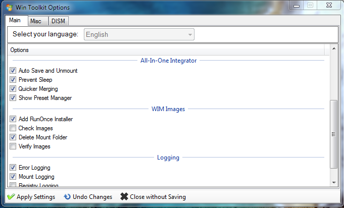

@Thiersee, Since the name of the ULs is the same (except for the date), it seems to be normal that the new one erases the older one. If you want to keep the old list, you have to rename it (ex. TEST-.ul), and place it in the WUD directory (extract .ulz file, don't double-clic on it). Have a look on my screen capture below. For this month I only added the new urls and deleted the 2 supesesed KBs (IE 11 and Update section, have a look on my previous post for changelog). For KB3006625 : I always compare for my tests the results of KBs asked by WU in my real machines (7 ultimate x64 installed in march 2013 starting from mooms update pack, 7 x86 pro installed in march 2014 with my UL, and 7 x86 HP installed in may 2014 using UL) and in my VM created (7 pro x86 and x64) with the UL from the previous month. This KB was asked by WU in all machines. But it's normal because all my work is based on moom's one for a minimalist update list ! What are your "not integrable KBs" ? maybe the answer is here... if some additional KBs are installed KB3006625 could be useless. But if these additional KBs are not in the list, it's because they weren't asked by WU after a fresh installation.

Thanks Thiersee for the infos ! So the pb seems that Wintoolkit installer doesn't work correctly. @ryback : si ces mises à jour sont liées au .Net FW, c'est qu'il n'a pas été installé correctement avec Wintoolkit installer. Avant de rententer une intégration, essaie d'ajouter un sfx de programme en plus sur Wintoolkit installer (CCleaner ou Firefox) : tu reprends ton ancien dossier de travail sur Wintoolkit, n'ajoute pas de KB, et ajoute simplement ton SFX en plus des autres avant de refaire l'ISO. Si après réinstallation ton programm n'y est pas, c'est que ça vient de Wintoolkit. Auquel cas attends la prochaine beta ou tente une ancienne version (pour ce que j'ai lu il y a eu pas mal de soucis avec Win 8.1 et Wintoolkit 1.5).
@ryback. Tout semble correct sur ta capture d'écran, mais perso je mettrais Virtual PC après les 2 KB RunOnce. Tu as l'air de travailler sur Win 8.1, moi je suis sur Windows 7. Peut-être que c'est là la cause du problème ? Vérifie toutefois ton ISO. J'ai téléchargé les miens l'année dernière lorsque j'ai commencé à miantenir les ULs, mais ils n'ont pas été mis à jour depuis (numéro de version identique). J'ai installé 7 Home Premium en réel pour un pote à partir de mon ISO sans souci d'installation, et j'ai juste choisi de faire mes tests sur 7 pro pour éviter d'avoir les 34 mises à jour de langue facultatives de WU après installation. Tu peux sélectionner l'exe du XP Mode en même temps que le setup d'IE 11 lors de l'intégration des mises à jour. Pour les SFX, pas d'ordre particulier, je mets en premier le RunOnce d'icare, et j'ajoute en plus les Runtimes microsoft (visual basic).
