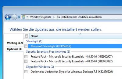

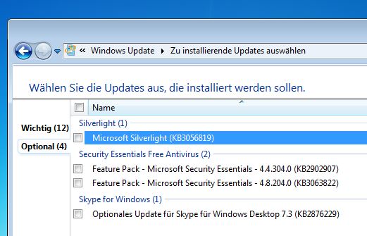

I have just finished a test on x86 (VM), but WU was not asking for it :unsure: !
I integrated all updates with DISM, then with WTK IE11+updates.
x64-test follows may be later or tomorrow.
post-26665-0-48811600-1437078243_thumb.j
post-26665-0-94983600-1437078244_thumb.j

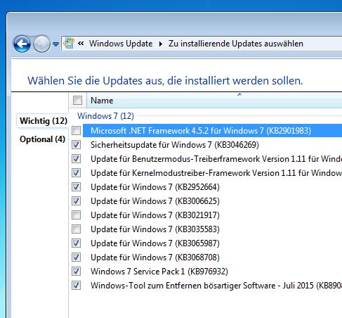

KB3050265: after a new reboot I got a WU-request for it!
KB3074886: the same as above,WU requested again KB3065822 but it was in effect KB3074886 (same size).
It means, forget my previous post ;)!
