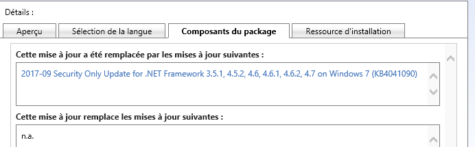

  1. @Unikat2000 Yes it should. KB4041090 is security only .net framework Rollup, but it includes the same things as KB4040980. I uninstalled this update in my VM, and effectively it's asked by WU ! A new WU bug ? In your case, did you a fresh installation with UL or just a manual uninstallation ? I stopped integration tests for classic installation and just do them for CR. If this update is still asked, I'll put it back.
