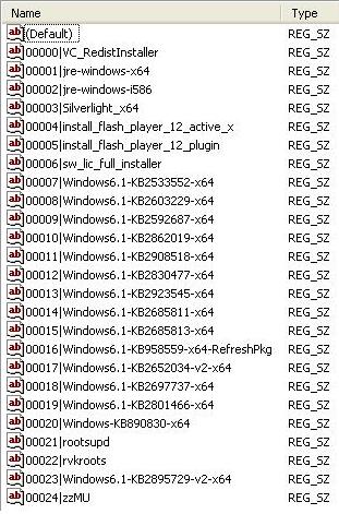

		Thanks KEiGHT for your suggestions. I ran WinToolkit on the same install.wim with nothing added except I changed the VC_RedistInstaller to the beginning. I'm not getting any errors here. I then mounted the install.wim in WinToolkit and used the Wim Registry Editor. The screen shot is below. This is showing exactly the order I want. However, RunOnce is actually installing in a different order as I posted above. It is installing the updates in alphabetic order. This is Windows 7 SP1 x64 Ultimate. I'm building this in Windows XP and installing in a VMWare Player VM. I think Legolash2o's recent changes to the RunOnce installer are causing this. Clark.

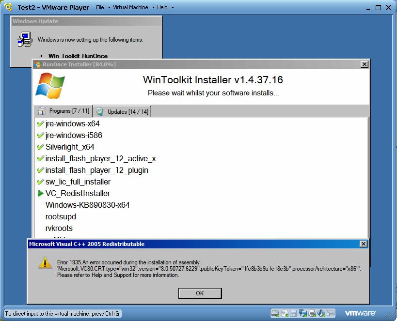

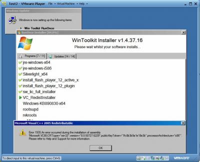

		@KEiGHT I *have* arranged the silent installs in the order I want using the arrow keys, but the RunOnce installer is re-arranging them. Let me make it more clear. In the saved session.ini, the order is: jre-windows-x64 jre-windows-i586 Silverlight_x64 install_flash_player_12_active_x install_flash_player_12_plugin sw_lic_full_installer VC_RedistInstaller Windows6.1-KB2533552-x64 Windows6.1-KB2603229-x64 Windows6.1-KB2592687-x64 Windows6.1-KB2862019-x64 Windows6.1-KB2908518-x64 Windows6.1-KB2830477-x64 Windows6.1-KB2923545-x64 Windows6.1-KB2685811-x64 Windows6.1-KB2685813-x64 Windows6.1-KB958559-x64-RefreshPkg Windows6.1-KB2652034-v2-x64 Windows6.1-KB2697737-x64 Windows6.1-KB2801466-x64 Windows-KB890830-x64 rootsupd rvkroots Windows6.1-KB2895729-v2-x64 zzMU The RunOnce log is saying it installed them in this order: Windows6.1-KB2533552-x64 jre-windows-x64 jre-windows-i586 Silverlight_x64 install_flash_player_12_active_x install_flash_player_12_plugin sw_lic_full_installer VC_RedistInstaller Windows6.1-KB2592687-x64 Windows6.1-KB2603229-x64 Windows6.1-KB2652034-v2-x64 Windows6.1-KB2685811-x64 Windows6.1-KB2685813-x64 Windows6.1-KB2697737-x64 Windows6.1-KB2801466-x64 Windows6.1-KB2830477-x64 Windows6.1-KB2862019-x64 Windows6.1-KB2895729-v2-x64 Windows6.1-KB2908518-x64 Windows6.1-KB2923545-x64 Windows6.1-KB958559-x64-RefreshPkg Windows-KB890830-x64 rootsupd rvkroots zzMU Notice that the "Windows6.1" updates have been rearranged into alphabetic order. On further examination, the problem I saw in previous builds with KB2895729-v2-x64 causing subsequent install failures is no longer occurring. Also, if I put VC_RedistInstaller at the beginning, I'll probably avoid the problem I'm seeing with it. However, there is another problem. The Virtual PC package Windows6.1-KB958559-x64-RefreshPkg is being installed *after* its updates Windows6.1-KB2652034-v2-x64, Windows6.1-KB2697737-x64, and Windows6.1-KB2801466-x64. So, those updates aren't getting installed. Clark.
		[Solved] RunOnce changes install order
		Hi, The RunOnce installer is changing the order of installs I originally specified. The relevant part of the session .ini: #Silent Installs jre-windows-x64::/s WEB_JAVA_SECURITY_LEVEL=M;NO;29.27 MB;F:\Win Toolkit\Installs Win7 x64\jre-windows-x64.exe;Always Installed jre-windows-i586::/s WEB_JAVA_SECURITY_LEVEL=M;NO;27.79 MB;F:\Win Toolkit\Installs Common\jre-windows-i586.exe;Always Installed Silverlight_x64::/q;NO;12.47 MB;F:\Win Toolkit\Installs Win7 x64\Silverlight_x64.exe;Always Installed install_flash_player_12_active_x::-install -au 2;NO;16.50 MB;F:\Win Toolkit\Installs Common\install_flash_player_12_active_x.exe;Always Installed install_flash_player_12_plugin::-install -au 2;NO;17.06 MB;F:\Win Toolkit\Installs Common\install_flash_player_12_plugin.exe;Always Installed sw_lic_full_installer::/S;NO;11.56 MB;F:\Win Toolkit\Installs Common\sw_lic_full_installer.exe;Always Installed VC_RedistInstaller::/VERYSILENT /NORESTART;NO;47.68 MB;F:\Win Toolkit\Installs Common\VC_RedistInstaller.exe;Always Installed Windows6.1-KB2533552-x64::N/A (Not Needed);NO;9.23 MB;F:\WHD\Updates\Windows7-x64_no\Additional\Not Integratable\Windows6.1-KB2533552-x64.msu;Always Installed Windows6.1-KB2603229-x64::N/A (Not Needed);NO;193.42 KB;F:\WHD\Updates\Windows7-x64_no\Additional\Not Integratable\Windows6.1-KB2603229-x64.msu;Always Installed Windows6.1-KB2592687-x64::N/A (Not Needed);NO;6.80 MB;F:\WHD\Updates\Windows7-x64_no\Additional\RDP8.0\Windows6.1-KB2592687-x64.msu;Always Installed Windows6.1-KB2862019-x64::N/A (Not Needed);NO;3.80 MB;F:\WHD\Updates\Windows7-x64_no\Additional\RDP8.0 Updates\Windows6.1-KB2862019-x64.msu;Always Installed Windows6.1-KB2908518-x64::N/A (Not Needed);NO;1.47 MB;F:\WHD\Updates\Windows7-x64_no\Additional\RDP8.0 Updates\Windows6.1-KB2908518-x64.msu;Always Installed Windows6.1-KB2830477-x64::N/A (Not Needed);NO;6.43 MB;F:\WHD\Updates\Windows7-x64_no\Additional\RDC8.1\Windows6.1-KB2830477-x64.msu;Always Installed Windows6.1-KB2923545-x64::N/A (Not Needed);NO;5.23 MB;F:\WHD\Updates\Windows7-x64_no\Additional\RDC8.1 Updates\Windows6.1-KB2923545-x64.msu;Always Installed Windows6.1-KB2685811-x64::N/A (Not Needed);NO;791.24 KB;F:\WHD\Updates\Windows7-x64_no\General\Windows6.1-KB2685811-x64.msu;Always Installed Windows6.1-KB2685813-x64::N/A (Not Needed);NO;1.11 MB;F:\WHD\Updates\Windows7-x64_no\General\Windows6.1-KB2685813-x64.msu;Always Installed Windows6.1-KB958559-x64-RefreshPkg::N/A (Not Needed);NO;16.30 MB;F:\WHD\Updates\Windows7-x64_no\Extra\VirtualPC\Windows6.1-KB958559-x64-RefreshPkg.msu;Always Installed Windows6.1-KB2652034-v2-x64::N/A (Not Needed);NO;344.30 KB;F:\WHD\Updates\Windows7-x64_no\Extra\VirtualPC Updates\Windows6.1-KB2652034-v2-x64.msu;Always Installed Windows6.1-KB2697737-x64::N/A (Not Needed);NO;1.70 MB;F:\WHD\Updates\Windows7-x64_no\Extra\VirtualPC Updates\Windows6.1-KB2697737-x64.msu;Always Installed Windows6.1-KB2801466-x64::N/A (Not Needed);NO;715.33 KB;F:\WHD\Updates\Windows7-x64_no\Extra\VirtualPC Updates\Windows6.1-KB2801466-x64.msu;Always Installed Windows-KB890830-x64::/Q;NO;24.45 MB;F:\Win Toolkit\Installs Win7 x64\Windows-KB890830-x64.exe;Always Installed rootsupd::/q;NO;447.33 KB;F:\Win Toolkit\Installs Common\rootsupd.exe;Always Installed rvkroots::/q;NO;195.33 KB;F:\Win Toolkit\Installs Common\rvkroots.exe;Always Installed Windows6.1-KB2895729-v2-x64::N/A (Not Needed);NO;793.61 KB;F:\WHD\Updates\Windows7-x64_no\Hotfix\Windows6.1-KB2895729-v2-x64.msu;Always Installed zzMU::;NO;53.87 KB;F:\Win Toolkit\Installs Common\zzMU.exe;Always Installed I've attached the RunOnce log. It looks like it is sorting the items it considers 'updates' in alphabetic order. When I install, the VC++ 2005 and 2008 (x86 and x64) parts of VC_RedistInstaller (McRips installer) are failing with error 1935 (screenshot attached). I had seen this in the past and found that I needed to install VC_Redistributable before KB2592687. The RunOnce log is showing it being installed *just* before, but maybe they are being installed concurrently? Also, I wanted KB2895729 at the end as I had seen problems where subsequent updates would fail after installing KB2895729. Perhaps it needs a reboot? Ultimately, I think it would be best to install in the same order as shown in the AIO integrator. The integration was done with v1.4.37.7, then I mounted/unmounted in 1.4.37.17 to get the RunOnce updated. Thanks for this great tool, Clark. WinToolkit_RunOnce_Log.txt
