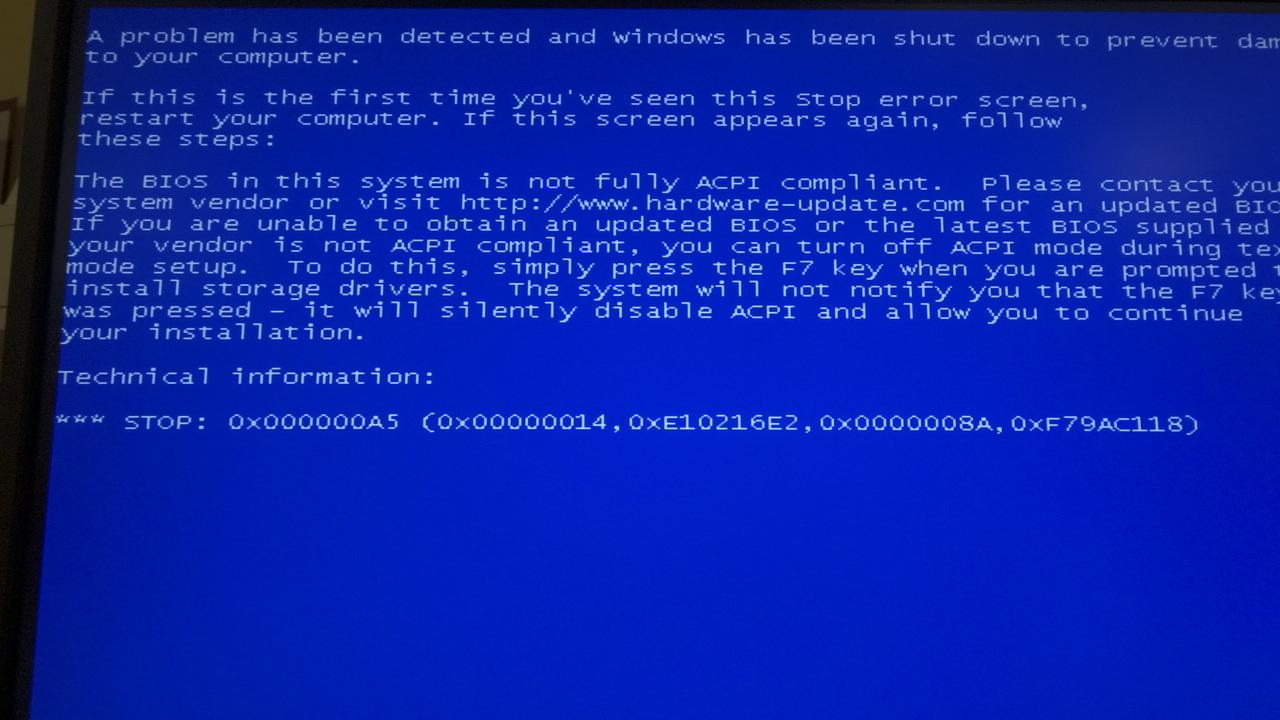

December 22, 20213 yr 1 hour ago, infuscomus said: @Thor55 OK, try - acpi 5048 - 2020.10.24 - daniel_k, diderius6 - see if that makes a difference. I tried, as you said, but without success, a message that is ACPI not fully compliant with the file acpi ..acpi.sys, larger than 200 kb, does not go immediately, then passes bsod 1 second Edited December 22, 20213 yr by Thor55

December 23, 20213 yr @Thor55 switch back to acpi 5048 for a sec, post a screenshot of the A5 BSOD you get.
December 23, 20213 yr 39 minutes ago, infuscomus said: @Thor55 switch back to acpi 5048 for a sec, post a screenshot of the A5 BSOD you get. please answer only this is still bsod acpi 5048 - 2020.10.24 - daniel_k, diderius6 file is 234 kb long i think it will never work that way but i'm not sure the acpi.sys size is wrong it might be 192kb correct i tried everything in the folder after kind all are bsod
December 23, 20213 yr @Thor55 It is unfortunate that you have such troublesome hardware. Sorry the existing patches do not work for you. @Mov AX, 0xDEAD @Dietmar BSOD A5 0x14 - ACPI could not parse the resource descriptor. The length exceeds MAXULONG. This one is unusual, thoughts?
December 23, 20213 yr 14 minutes ago, infuscomus said: @Thor55 It is unfortunate that you have such troublesome hardware. Sorry the existing patches do not work for you. @Mov AX, 0xDEAD @Dietmar BSOD A5 0x14 - ACPI could not parse the resource descriptor. The length exceeds MAXULONG. This one is unusual, thoughts? It is unfortunate that you have such troublesome hardware. Sorry the existing patches do not work for you. @Mov AX, 0xDEAD @Dietmar BSOD A5 0x14 - ACPI could not parse source descriptor. Length exceeds MAXULONG. let me wait for the next fixes when the authors try this asus prime x299 deluxe II board to make the acpi work for future installation each board i don't know if it has anything different acpi in bios acpi generation are set for processor generation settings in bios and more

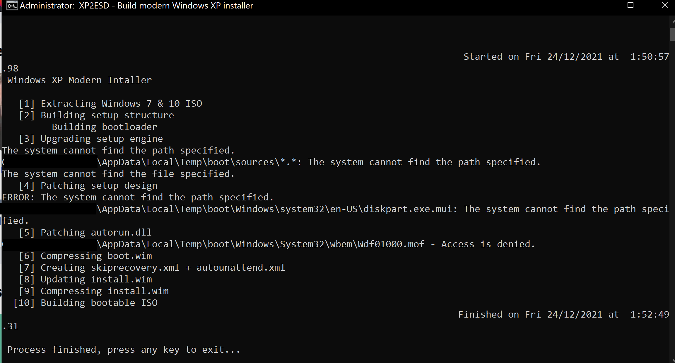

December 23, 20213 yr 2 hours ago, infuscomus said: @George King I'm still confused. Your image is corrupted, remove folders with _ in XP2ESD folder and clear temp and %temp%
December 24, 20213 yr @ExtremeGrief OK, I'll do that. P.S Is there a guide I can use out there somewhere? I'm not even sure I'm doing everything in the right order, I'm just guessing.
December 24, 20213 yr @George King @ExtremeGrief grr! I can't delete the temp files! even when I run as admin! damnit! how do I get rid of them now?
December 24, 20213 yr 1 hour ago, infuscomus said: @George King @ExtremeGrief grr! I can't delete the temp files! even when I run as admin! damnit! how do I get rid of them now? Use takeown and icacls to give yourself permissions, or use Unlocker app
